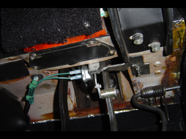

I have this old picture of a nearby part that also shows the switch arm extending down and resting on top of the brake pedal arm. You can just see the end of the bracket to the right of the open heater vent flap. There are two bolts holding the bracket onto the bottom of the area to the left of the steering column support and to the right of the brake pedal. The bracket is a piece of steel that by using trial and error, I cut into a rough shape, bent to the correct angle to fit into the space, welded a sharp transition to strengthen it at a vulnerable place and then I drilled a couple of mounting holes to fasten the switch and a couple more that fasten the bracket to the car. If I get some time, I'll get a better shot of the bracket.

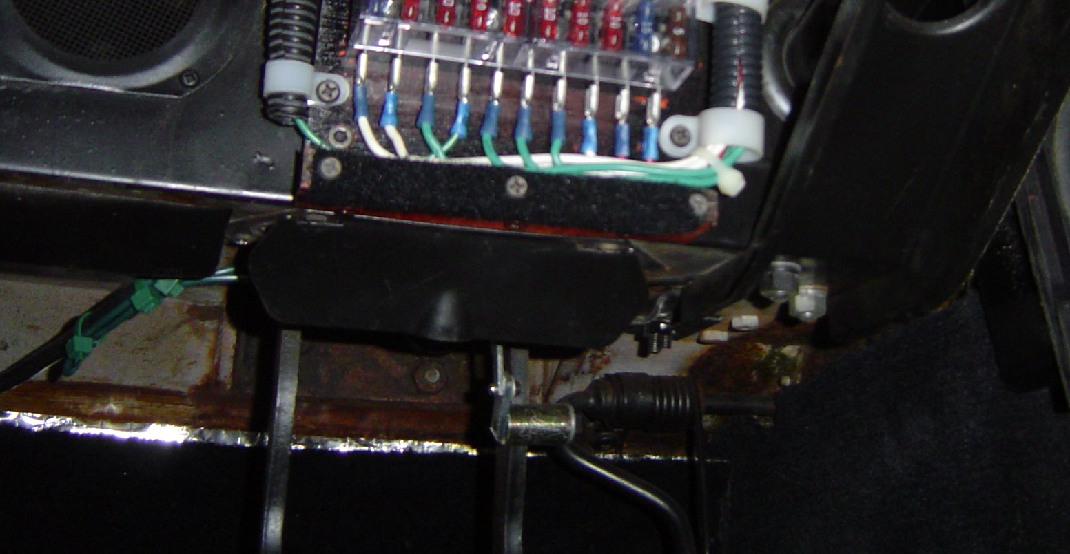

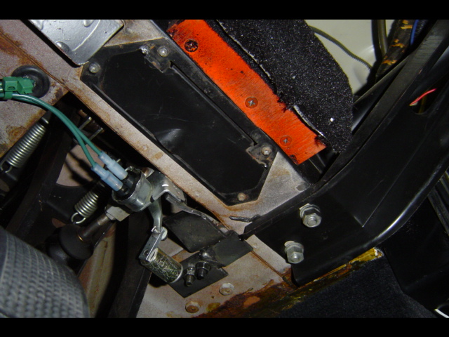

I snapped a couple of pictures from the floor straight up. As you can see, the bracket attaches with two screw through the sheet metal right outside the pedal box. Notice how the bracket holds the switch up inside the pedal box out of the way of everything. I ran the wires out the same grommet as the wires to the headlight dip switch. I also cut off the lower half of the adjustable arm that comes on the switch. I also added the big round piece of metal to provide a smoother surface between the top of the brake pedal and the switch actuator arm. In the engine compartment, right next to the steering column, near the edge of the pedal box, I drilled the two mounting holes. I waterproofed the bolt heads with black RTV once I mounted the bracket.
