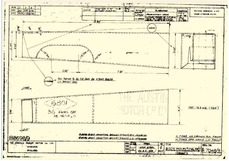

Has anyone got a diagram they can post with the shape and dimensions of the cutout required so that the exhaust pipes can clear the outrigger on a BJ8, or is it just a case of make it big enough ?
steveg
Angus, here it is:
BN6
BN6
Member
Wow, thank you very much for the info, that was indeed quick.
