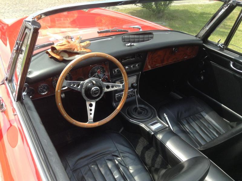

Hello...first excuse my small english...i am a Healey Driver from germany....who can give me a tip? (advice?) I cannot fitting the flasher unit in the steering wheel hub. Its a original moto-lita Adapter. I have a new flasher unit with a short tube and and thick aluminium baseplate. The original unit had a thin steel baseplate. Its not possible to move the unit in the hub with the flasher knob on 12 o'clock.
The Picture Shows the unit before i made the mistake....

The correct way for the 3 spoke steering wheel is to have one of the spokes at 12 o'clock, not 6 as in your photo. That way the other two spokes provide a better sight of the gauges
Keoke
That position U stated is correct for a three spoke original Healey wheel.
However, for Joey's wheel the position shown is correct.
MKII Joey, which ever 3 spoke steering wheel you have/use, set it up so that you can see the gauges. That may be with the spoke at 12 or at 6.

But the Problem is it was previously installed as you can see on the pics. It seems there is a problem with the tube at the end from the turn indicator. It no longer fits into the steering column. There's a back stand that prevants the inserting of the unit. I can turn and move it as i like it doesnt fit into the moto-lita hub.
