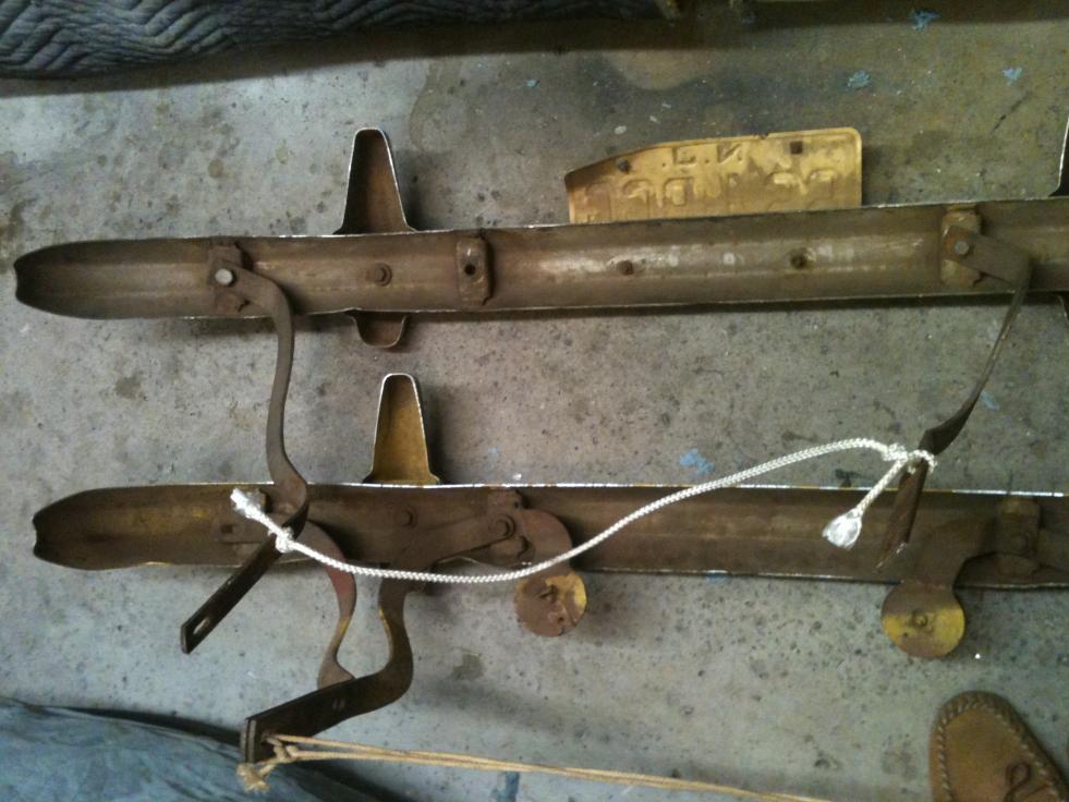

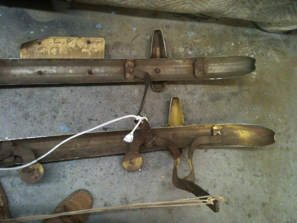

Chris_Masucci
So this is what I have. Mangled as they are, is this a front and a rear?
Keith_M
Based solely on the mounting brackets, the bottom one came off the front.
BigGreen
Someone mixed up ;-)
Looks like both have the type of bracket that belongs to the front

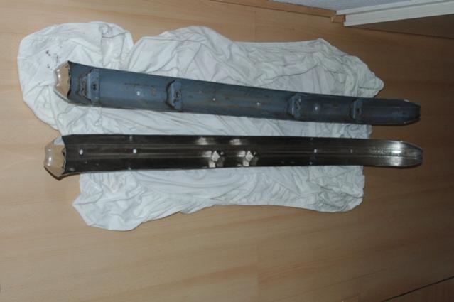

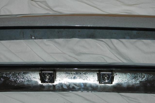

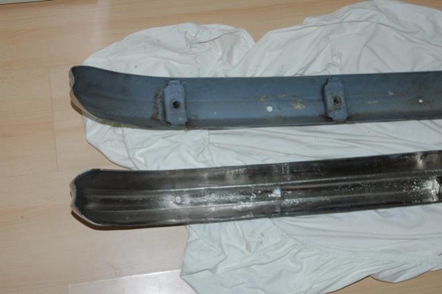

BigGreen
In these pictures the grey one is the Front, the shiny one is the Rear
