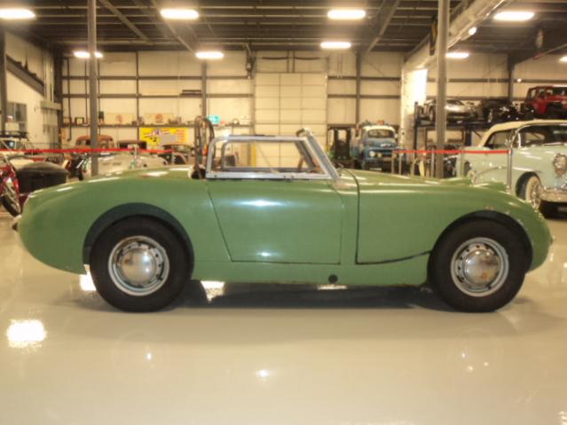

Newbie here. My Bugeye is about stripped and ready for blasting. I have been researching this forum and other sites to help me decide what I want to do. Oh, all the wealth of information out there!! I finally have a plan. I have a good 1275 engine and ribbed transmission to install. I will do a negative earth conversion, front disc brake conversion, and maybe change the gear ratio to 3.7 or 3.9.
Any advice or recommendations as to what other things I need to consider or do? I will get Gerard to rebuild master cylinder, but I need to find disc brake setup to swap. No British cars in salvage yards around here. Ebay has them occasionally, but what would be a good price? Same question about the rear differential too?
What model # speedometer and tach do I need? I have the working originals, but I don't think they are the right ones for my plan.
Iris blue or cherry red? Decisions, decisions!!

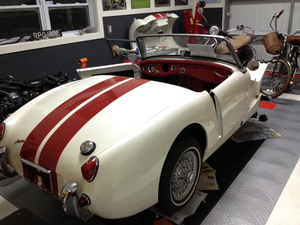

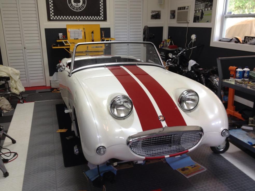

Hi Jim. Here are a couple of pictures. I used the PPG Deltron basecoat/clearcoat paints. The red is the Deltron DBC medium scarlet color. The old english white, I believe, I just had matched from an existing color. I used the PPG DCU 2021 clear. I really like the color combination.
I got the interior from Moss. Red seats, red carpet, and red top. Maybe if I was going to do this again, I might spring for the leather seats rather than the vinyl (I've spent so much money so far, what difference would it make??)

Your car is looking fantastic. Looks like you have a nice work space too. How 'bout some pix of the engine bay?

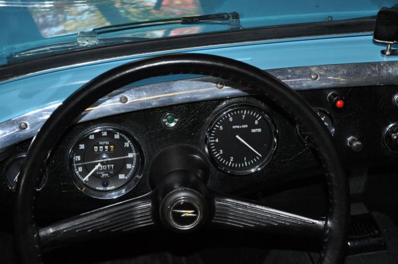

I have the original gauges, but know that they won't work correctly for my set up. What #s do I need with the conversions I plan?
Jimflorida
Hi Pat: I am finishing up my renovation of a 59 Bugeye. If I understand your questions--with the upgrades you plan, you should be able to use the original Speedometer. I changed to an alternator too, and was planning on taking a later electric tach and modding it to use the original Bugeye tach face, which some others have done, but after a lot of reading about the conversion and taking apart several tachs, I just bit the bullet and sent my original tach off to Palo Alto Speedo to have them do it. They did a good job.
