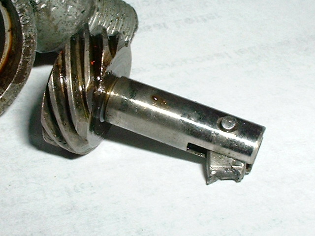

Spoke to a fellow Healey guy the other day and I mentioned to him that the small square drive was broken. He said that he had taken a section of square drive speedo cable and fashioned a replacement for the one he had. He filed it flat, drilled it for the pin. Has anyone here ever done such a thing with success? I don't want to spend $300.00 on a part that can be fixed easily.

HI Rustynuts, Many times the little short square drive pin has been replaced in the Volvo Cars. However, rather than doing it my self I had a Speedo shop make them for me they have a press that will square a round cable. This insures that the wire strands at the ends do not unwind when the the cable is cut into the short lengths---Fwiw--Keoke

I already have the drive apart, all I need is the part. Does this fellow happen to sell just the square drive pin?

Here's a pic that shows the gear and the small flat tab that the square drive was attached too.
