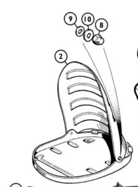

I have a 1960 TR3A and would like to install TR3 seats (currently have modified TR6 seats), but I find the seat back angle uncomfortable; they're too upright.
I was wondering if anyone thought it feasible to take the forward tilting type of seat (like this one) and modify the hinge assembly or mating parts to give a permanent rear angle that is about 10 deg tilted further back.
Any thoughts? Has anyone done that? Is there a better way to get a more comfortable angle while retaining an original(ish) look?
thanks, Craig

I'm just a newbie, but could raising the front of the base accomplish it? Maybe weld or bolt in a wedge from the floor or onto the seat. It would maintain a stock look, and would be reversible if done right.
STeve 1958
Raising the front of the seat would result in your knees rubbing on the steering wheel unless you install a smaller wheel. I already reduced to a 15" wheel. The Simplest thing I found was to add more padding towards the bottom of the seat back. This helps but only and inch or so.
C
cluker
I had thought of simply tilting the whole assembly too, but the steering wheel almost brushes my thighs already.
So what about my idea for a little surgery on the tilting seat back? I don't mind experimenting, but I'd like to know from more experienced folks if it's a goofy idea before I start.
Thanks, and Merry Christmas!
Craig

so your TR6 seats must not have the option of reclining? I use TR6 seats in my TR4's. The primary reason I use these seats is to use the reclining position. I agree that the stock seats are way to far forward. However as a young man in my twenties I did not have a problem with them.
TomMull
It seems to me that the TR3, as well as many period cars, had seats that were designed with a driver position that is quite different than today's semi relining with arms straightened style. (NASCAR still uses the old position with the steering wheel close and in your lap.)
I'd suggest that you consider adapting your driving style to the period seating. It's awkward at first but you get used to it and it suits the car.
Tom
STeve 1958
Simply relocating the bolt hole for the seat hinge will work for one seat, not the other. It will cause some added stress on the bolt and on the bottom of the seat back. These could be reinforced a little to keep the back from buckling or the holes from elongating. My car has a roll bar which the DPO located to close to the seat so I have no more room to adjust.
C
cluker
Tom
I have been doing that and agree that it's possible to get used to that "close in" position. The problem is that my back doesn't like the very upright angle.
Thanks to everyone of the replies. I think I'll risk ordering some new seats and will attempt some modifications on them.
Craig
