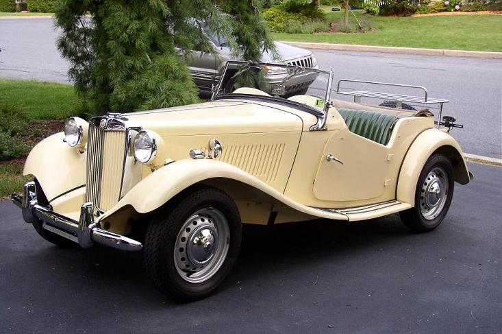

martyc
First time owner of a LBC. I've owned the TD for about a month and a half. It's an older restoration, some basic maintenance items that I'm working on that the previous owner let go (empty dampers, replaced steering boots and tie rod ends, etc). Runs OK, but needs a tune-up which I'm in the midst of. Will probably be rebuilding the carbs (a winter projec!), looking forward to getting it running well enough to really drive it. It's no trailer queen, but it is in nice shape as far as I can tell.
I've attached a picture of it from the day I brought it home...
