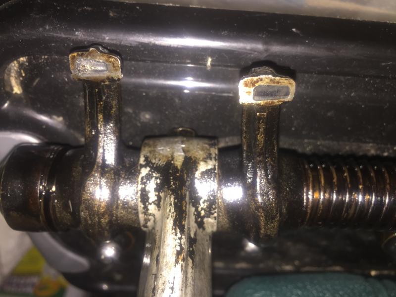

Ok, just popped the rockers off. Not really too warn. It's a little polished. I put a straight edge on it and the worst one might off at most .0001". Not much.
So any thing else that might cause this? I did press down on the valves when I had the rocker off. None of them were stuck, but the one giving me a hard time sounded "squishy"

The actual rocker shaft was not pitted and scared on the bottom? The engine was probably gone through then or did you look at the tips only. The rocker also has a brass bushing that wears out so bad it can be missing. I have seen engines were one or more setting was reduced to .03 setting warm to quiet a loud engine and the car ran fine for years, but that is one of those things people do not talk about.
I must admit I am surprised the rocker assembly is in good shape if you did not have it done. If you have the rocker shaft removed still, slid the rockers side to side into the spring and look closely and make sure before you re-install.
