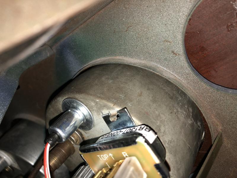

As for the regulator mounting/grounding, here’s a pic of how I have it. Top is pointing down, because logic. This is the exact one I bought:
https://www.spitbits.com/store/6-VOLTAGE-STABILIZER-GT6-P2145.aspx
it has to be mounted downward because of how it screws in, and where that little “foot” is. Having “top” actually be top, I can’t screw it in and the bracket would be too long to fit in the “foot.” Was I sold the wrong part?

The stabilizer you bought is not necessarily right or wrong. Unfortunately it is nearly impossible to read the output from one with a digital meter to determine if it is working. Regardless, it looks like your stabilizer is on the speedometer. Make sure the speedometer has a good ground. Usually a black wire with ring terminals on each end is used. One ring terminal goes on a gauge mounting stud under the thumb nut and the other is screwed to the chassis somewhere behind the dash.

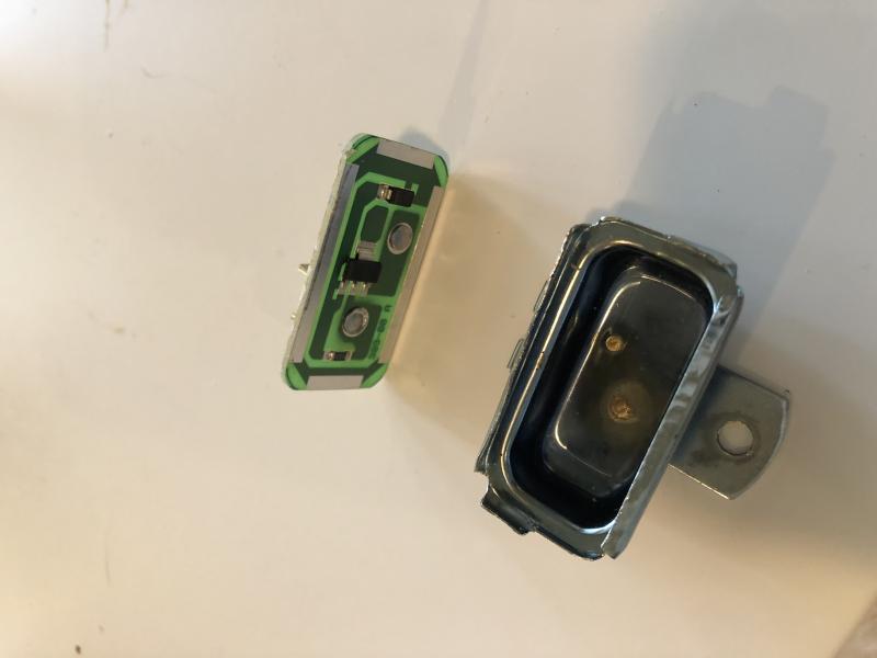

As a footnote, if you do determine that this voltage stabilizer is at fault, I suggest buying a solid state one. Spitbits does not offer them but others like BP Northwest do. The solid state stabilizers deliver a constant 10V when powered on and they do not have to be oriented with "TOP" up. They also have become less expensive than the electromechanical ones.
I’ve attached a pic of the voltage stabilizer I got from SpitBits. Sure looks like a solid state to me. I attempted to flip it backwards so that “Top” would actually be on top, but broke the grounding bracket weld in the process, so I had to screw it back together with a tiny bolt and nut. Reinstalled it and the exact same result as before. I went to test it with the multimeter and shorted it. Sparks flew, and both gauge needles fell back down.

Why did you take the stabilizer apart? To put it back together, place the board in the metal can and use tiny vise grips to squeeze the flanges of the can back into firm contact with the board. I am going to PM you with some volt meter instructions.
You have confirmed the stabilizer is solid state so the "TOP" designation doesn't mean anything nor does it need to apply. What it does say is that with NOTHING connected to the stabilizer's "I" terminal, battery voltage supplied to the "B" terminal, and the case providing a ground path... you should measure 10V DC between the "I" terminal and the car's body.

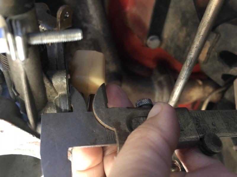

I mentioned my test drive to my husband last night, and he said that it sounds almost as if the car was running on just one carburetor. Today I unscrewed the problem carb. The one that previously would flood, and that I had to customize a newer float. Well, the bowl didn’t have much fuel in it. The float also did not meet that recommended 17mm raise limit. ...and the float valve was stuck YET AGAIN! So I made some adjustments, cleaned the float valve (again) then test drove it. It had just rained, running out of daylight, and my tail light cover was still not installed, so I only drove it up and down our street on the hill, and it preformed beautifully. It shifted smoothly and did not question me at all whenever I politely asked it to accelerate for me. I will have to test drive it for real tomorrow and see if I can start it back up again after being driven (simulating my trip to the drive in restaurant, where the engine flooded).
The surging issue I think solved itself. Simple logic says that getting in causes the car to lower/dip briefly. This sudden change in elevation causes additional fuel to go into the starving carb, increasing the RPMs.

after uploading the pictures, I noticed that you can’t tell anything from them. The bowl actually isn’t empty. It is about a centimeter or less deep with fuel, and the measuring caliper is set at 17mm
