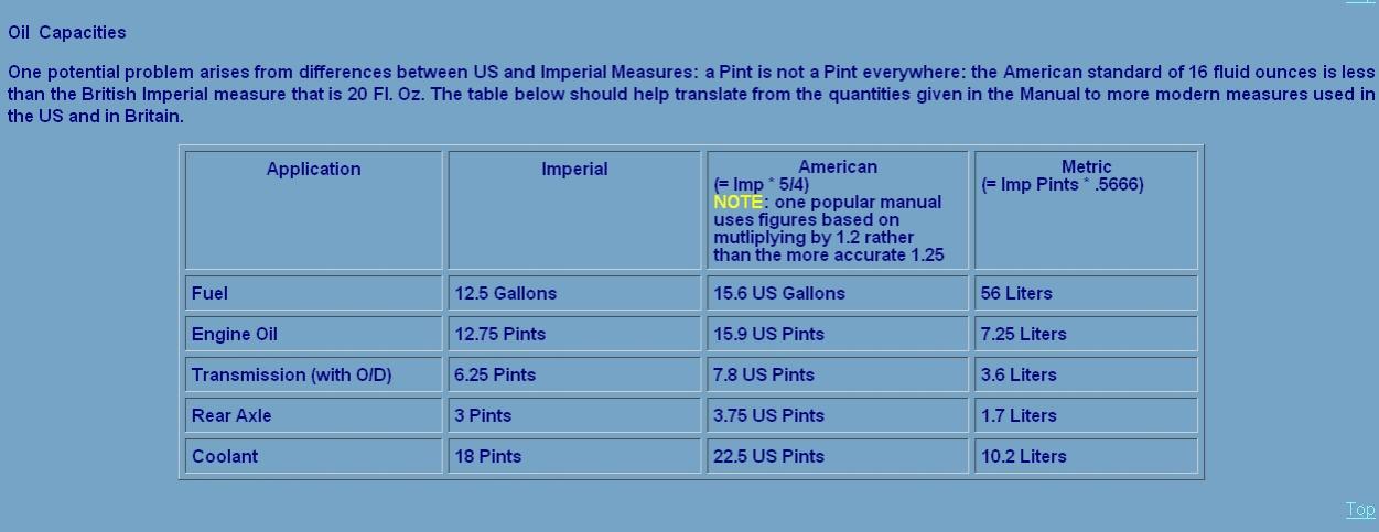

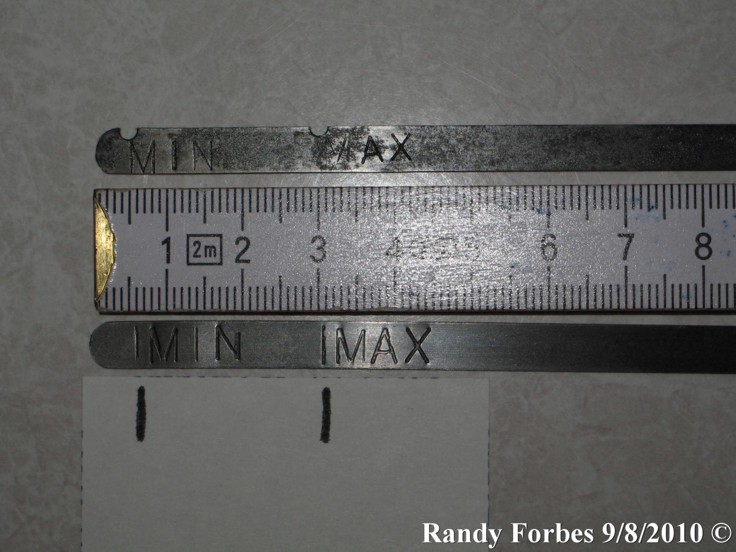

There are TWO thinking schools-
on the AH 100/6 Longbridge
If people respects the dip stick line you will find a 6-6 1/2 Liter -if you cover the MAX writing on the dip stick
IMG_3180DIP STIKoil.jpgyou find a 7-7 1/2 pint - I prefer to fill 7 or 7 1/2 Liter on my engine, level have a very little increase, but we have more warm dispersion(I have also the oil radiator MOD) and a little oil splash in the basement that can be help in the cold start and haven't contraindication, and we respect the builder indicationsOIL FUEL CAPACITY1.jpg

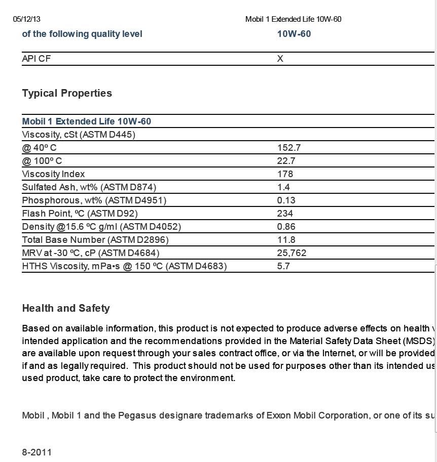

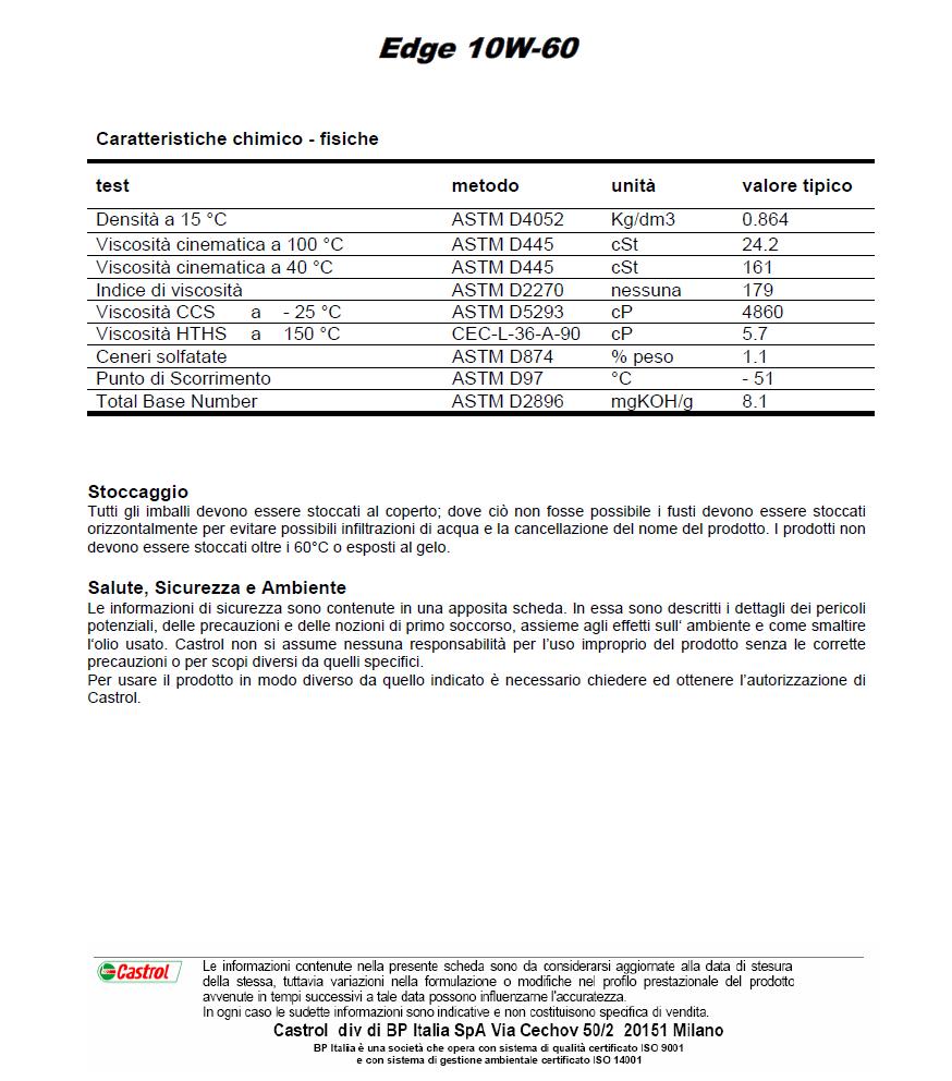

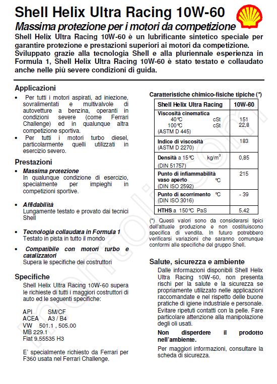

Actually for my second Oil change, I must decide the definitive oil for my car (I don't agree changes for the future)
I have selected 3 Full Synthetic SHELL - CASTROL - MOBIL 1 --all with 10W60 gradation
MOBIL 1 probably are the best, but actually I never find it in EU continental (only in UK)
SDPT.jpgCDPT.jpgMDPT.jpg I am very hesitant but probably SHEEL will be my choice-- any suggestion pls??
Hello Andrea, The Bentley manual specification for oil capacity and my BJ8 dip stick "full"line are the same...7.650 to 7.800 quarts. I simply add the small amount of oil left over and be done with it. After all, our Healeys need a little oil "reserve"to make up for the dripping on the garage floor! Lol.
Getting back to our forum friend "Ausmhly"who says his oil changes take only 6 1/2 quarts for his 64 BJ8...should be interesting to see why he has been adding only 6 1/2 quarts. My first thought was he may have the wrong dip stick with his car! The 100/6 and four cylinder Healey 100 require more oil then that.
