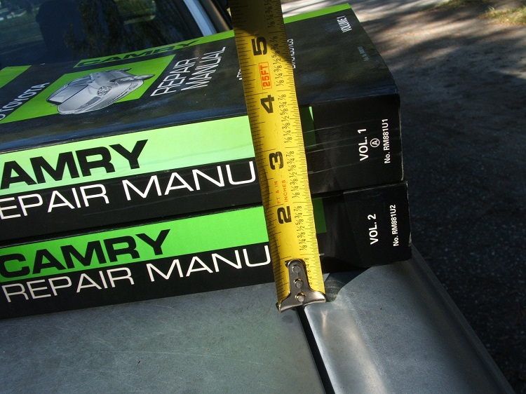

measuring manuals by the inch instead of pages seems to be the norm these days
1958 Rambler owner's manual: 56 pages
2017 Nissan Altima owner's manual: 498 pages. Radio/audio section: 117 pages.
That's just the owner's manuals - not the workshop manuals!
