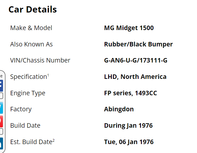

So, I just put my VIN in the decoder and this is what came up:
