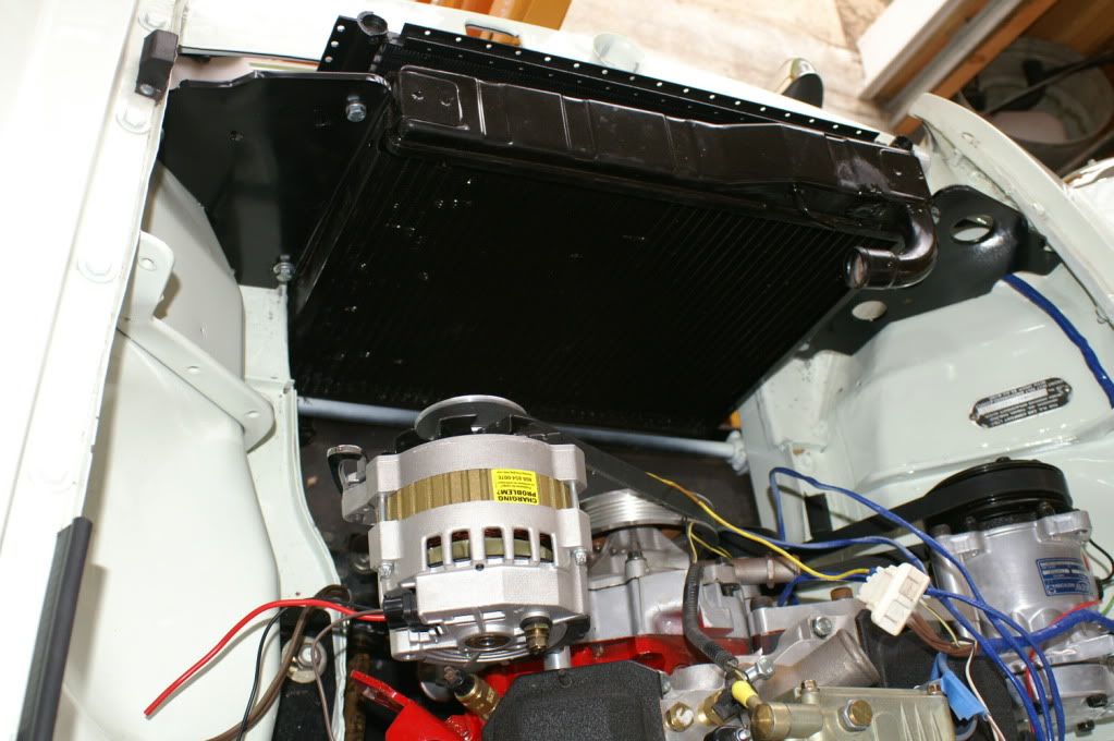

More progress!
Yesterday, I got the radiator mounted. Part of the conversion involves relocating the radiator a bit forward of its stock location. Which involves cutting away part of the apron and mounting new panels to the fenderwells. It also sits lower, part of it being below the apron. It will require bracing on the forward side, but I have to mount the A/C condenser before I can do that.
Also got a bit more done on the interior. Tucked away some of the exposed wiring behind the dash. But I can't complete that until I'm sure all the bits work. And that isn't going to happen until the engine is started.

Here ya go:

Got a lot done today! The fuel line is run and the fuel pump is installed. Radiator is in and finally managed to find/fabricate the hoses. Coil and distributor are installed and wired. Cooling fan is installed and wired with the proper controls and relay.
Have an all-day meeting tomorrow; otherwise, I think I'd actually try to start it then for the first time! Just a couple of loose ends to tie up, but she's ready to fire!
