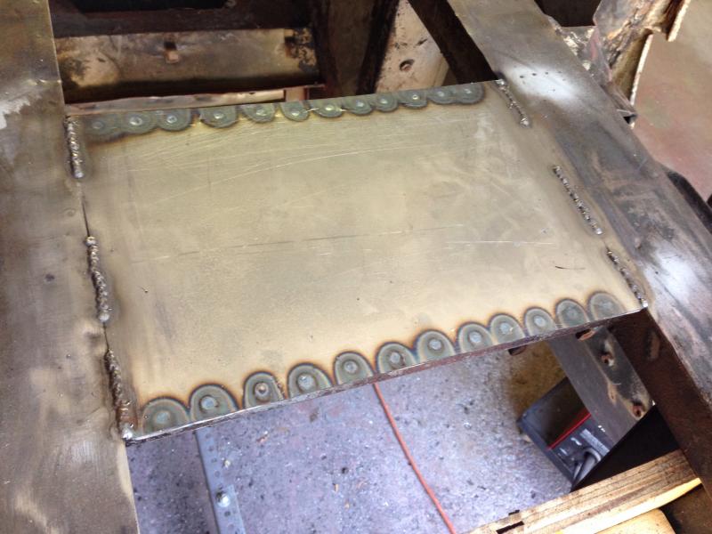

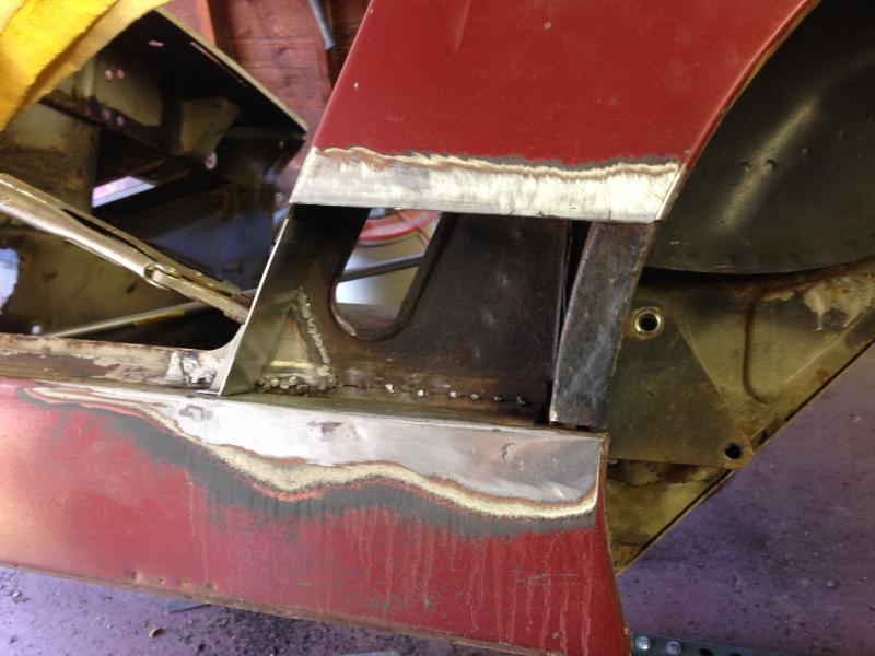

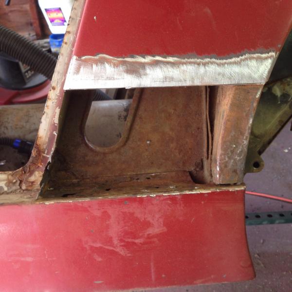

I thought I would start a series of pictures and descriptions of the work I will be doing to bring my Bugeye back to a solid rust free specimen.
The first area I tackled was the b post bottom. Initial inspection made it look like it was an easy fix. Nope! Fortunately I learn kind of fast. I won't make that mistake again. Although in the end I think being harder than I thought made me learn a few things that I will need to know for the rest of the repairs.
Remember I was an electrician all my life not a welder or body man.
The he pictures tell the story of how things progressed.
Jim_Gruber
That looks pretty good to me. Keep it up.
Bayless
Pretty nice work there.

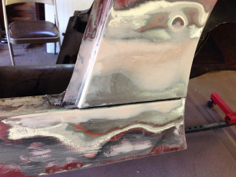

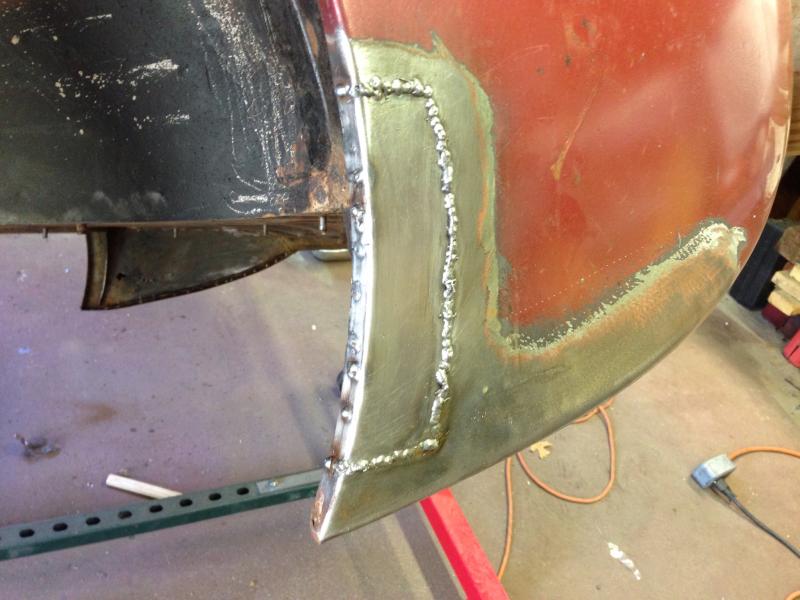

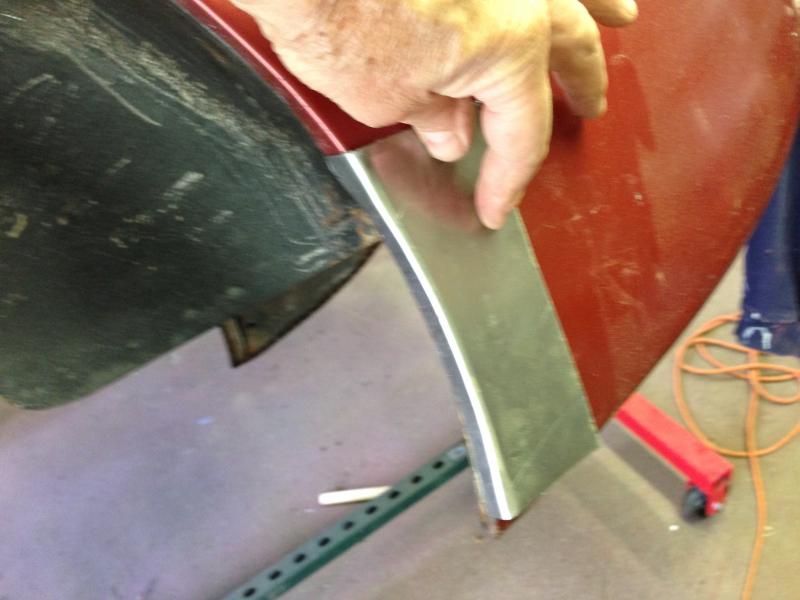

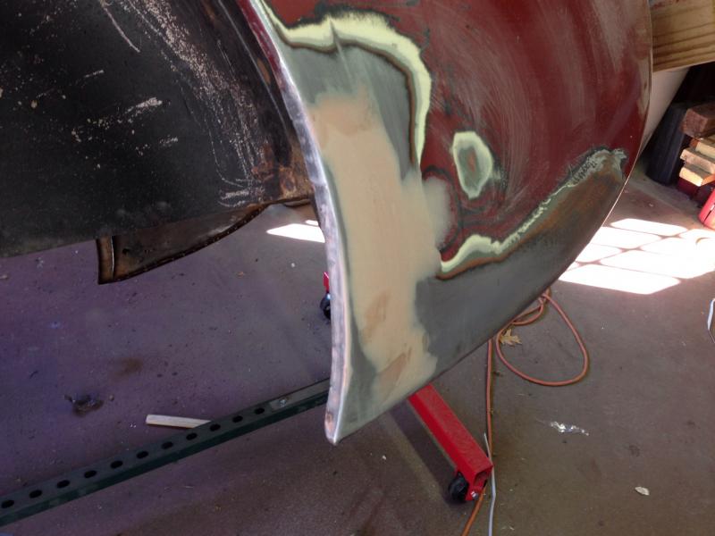

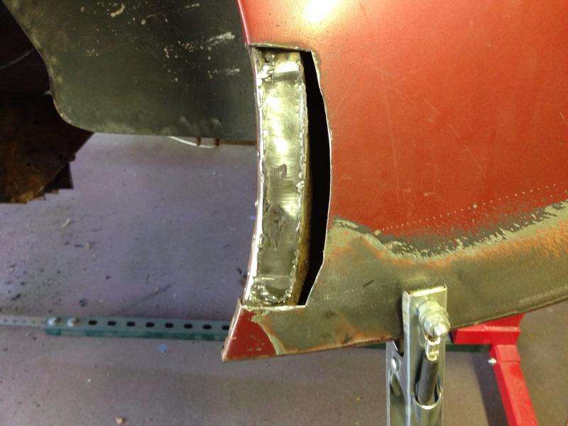

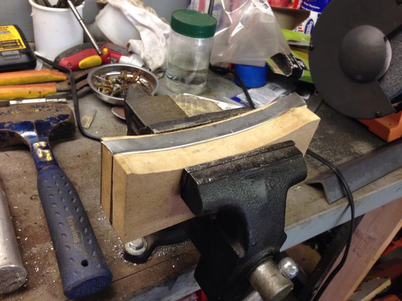

The next challenge was to make a patch for the rear of the wheel arch. I made a buck out of MDF to get the proper radius to start with. Since the area has a compound curve and I don't own a Shrinker I made a few relief cuts to be able to get the shape I needed. Those got welded once the piece was installed.
Of course the inner arch was perforated too so I made and welded in a piece for that too.
Next up is to try to make a piece for the front of the outer rocker. I think I can do it using the same technique that I used for this patch. If not I will break down and order left and right rockers. I only need about the first 8 inches on either side so I hate to buy whole rockers and not use most of them.

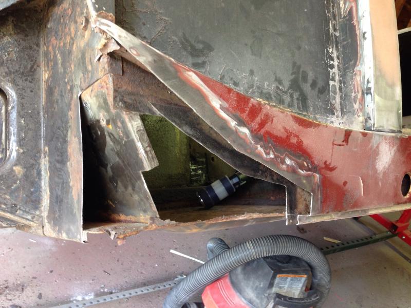

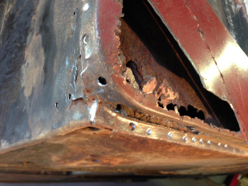

Thanks. I have been away for several days but will be back in the garage shortly. Have an ugly area at the front of the drivers side rocker. image.jpg
Rhodyspit75
Rhodyspit75

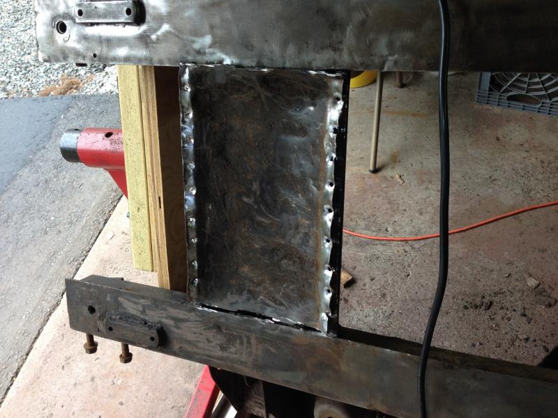

Next i I will attempt to fabricate a panel for the front of the outer rocker. Wish me luck!��

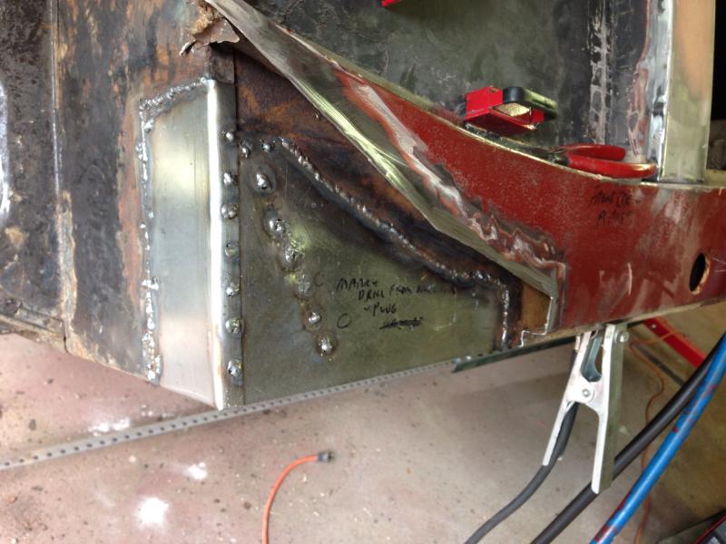

All the internal areas that I can reach are being wire brushed and the debris blown out. Areas that I can get to are given a coat of rust converter. Once all the welding is done then I plan to coat all the cavities with internal frame coating. My concern with coating the metal first then welding is that the coating will get burned off in the areas that need the most protection.

Rust converter on the stuff you can spray, weld thru primer along the contact points, and the Eastwood internal frame coating works very well. One can will do the sill cavity on each side twice and make sure it's done before the car is painted. It will drip out of any holes and soften the paint and it's impossible to remove even when fresh.
Rut
Brinkerhoff
Sandblasting the metal you are welding to and spraying the internal pieces as you go then coating with 3Ms weld thru primer is the only way to go.
Brinkerhoff
I meant blasting the metal clean and spraying with weld thru primer before you start piecing it together. You also blast and prime the the backside of your patch with weld thru primer.

I have weld through primer but I don't have a sandblasted. I could borrow one but don't want to have sand all over my garage. I can't move the car out because my driveway is steep and it would end up in the street. I'm using a knotted wire wheel for paint and heavy rust removal.

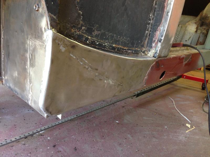

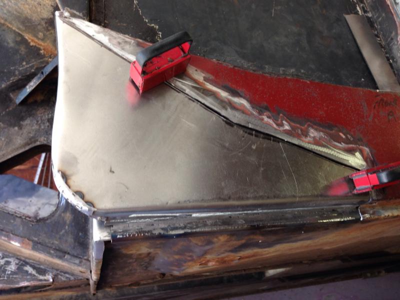

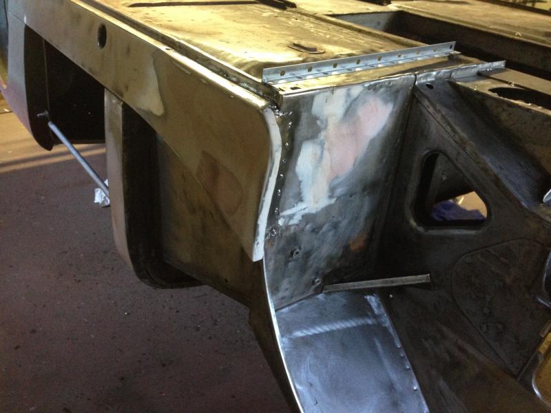

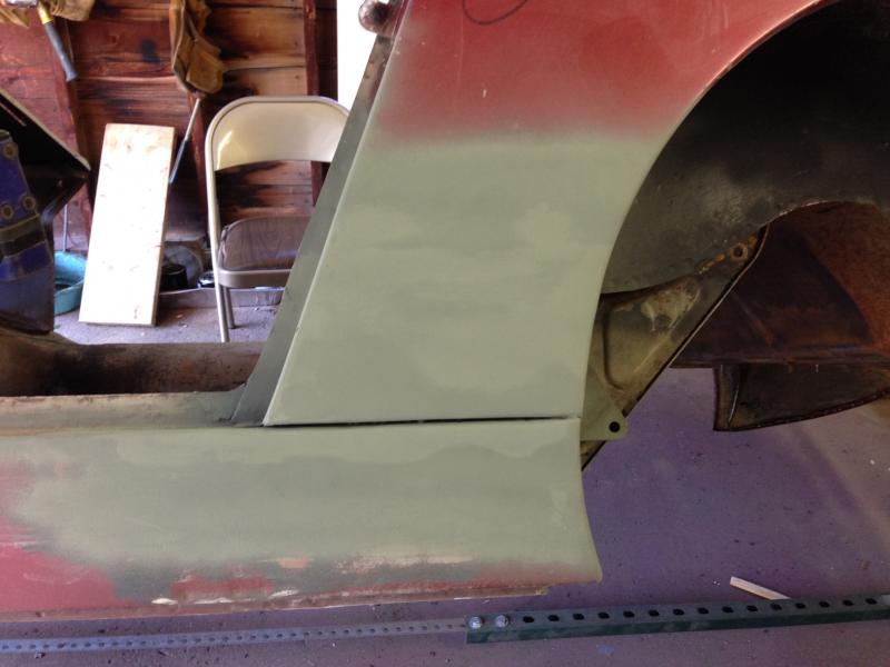

Anyway heres the progress. Fabricating the repair panel for the front end of the outer rocker. It had to be made in two pieces because I couldn't bend the three bands required for the lower edge.
I know now I could have bought an after market rocker and used part of it but I wanted to try my hand at metal forming. And yes it took a long time to get this far but I'm happy with how it's coming out.
