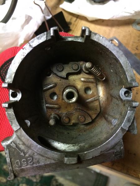

When you say "not smooth", I'm assuming you're writing about the minor elevation differences in the main mating on the dizzy versus the obvious notches. If so, which of the suggested caps is contoured with those variances? I pulled the distributor, and it is definitely the fact that my cap face is smooth along its mating face, and the distributor mating face is not.

I replied, but apparently incorrectly. So, again-
When you say "not smooth", I'm assuming you're writing about the minor machined elevation differences in the main mating surface on the dizzy versus the obvious notches. If so, which of the suggested caps is contoured with those variances? I pulled the distributor, and it is definitely the fact that my cap face is smooth along its mating face, and the distributor mating face is not.​
If I understand you correctly, you are saying that the surface at the top of your distributor that the cap fits against is not smooth. Aside from the notches that fit the notches on the cap, the surface should be smooth. If you could post a picture, that would help.
Look at about 4 & 8 o'clock. It isn't a uniform surface, it's machined that way. I'm guessing the uneven wear I witnessed in the cap was a little bad luck... perhaps the cap was a tad off center or the clips were not properly seated.
I would at first glance say that the dizzy needs to be filed/shaved so the cap surface is perfectly flat.
