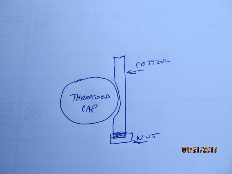

From the outside it looks like the cotters should push out after removin the nut & washer but they don't. The pins actually have a curved section cut out in the center of the length - this curve matches the diameter of the screw caps and sit in a groove cut into the circumference of the cap.
So what you need to do is loosen the nuts and then tap the pins up just a little, maybe a 1/16 or so, and then you can unscrew the caps. IMG_1890.jpg
Apologies for the very crude sketch but hopefully you get the idea.
attachment.php

Elaborating a little bit on Dave's sketch, here's a look inside the outer end of a lower control arm, where those cotters and cups reside. You see I've made on a note of my findings, so DO READ THE MANUAL (preferably, the Bentley Complete Austin-Healey 100/6 & 3000 version) to set up the clearances correctly (those threaded caps HAVE TO have room to unscrew & screw in during full range of travel__this is best done before the springs are installed).
