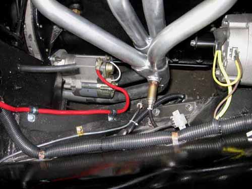

The harness metal tabs on my car never had any plastic or other type of tubing covering them. I haven't owned the car from new, but it seems odd that someone would just remove everyone of them. Is it something they started to do in the later cars??
Edit: BTW, I never did cover those tabs with anything. Since I installed the Dan Masters Harness, I covered all of the wiring with that split, corrugated type covering.
