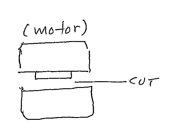

I cut them like this. Mounted the motor a couple of years ago and working fine.
Suggest blue loctite on nuts so they don't have to be too tight.
A diagonal cut from top to bottom, on the side, as suggested by British_Recovery, is the way to go. With the help from some soapy water and a pair of pliers, I was able to "screw" it into the hole just as he said.
