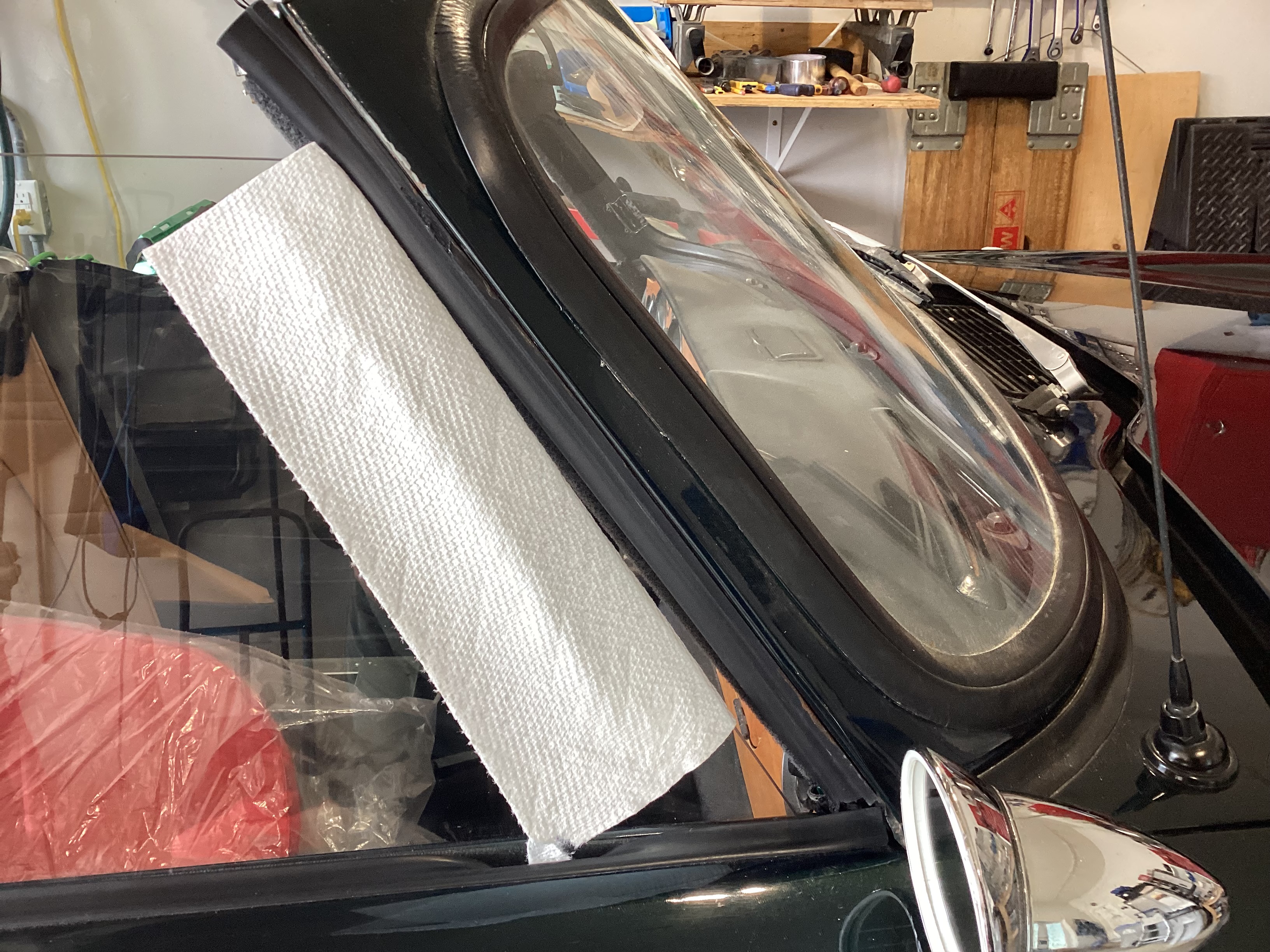

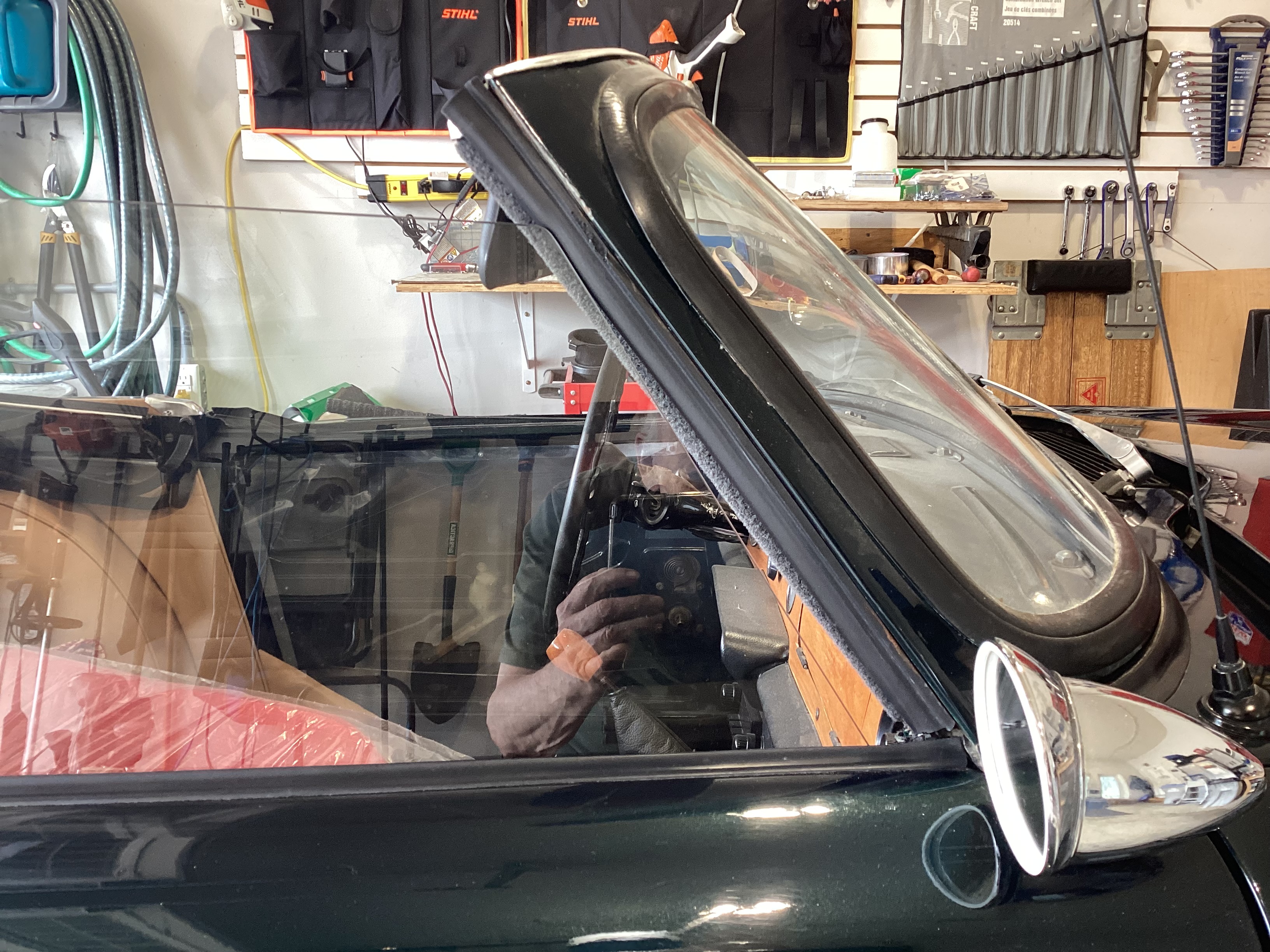

The passenger window doesn’t roll up properly. It was very hard to crank up and I haven’t been able to roll it all the way up because the glass isn’t aligned. It rubs the windshield frame about 2 inches below the full up position and it forces the glass out as you try to roll it all the way up. I have been replaced the window regulator and adjusted the slides as much as you can, but the glass still isn’t aligned properly.
I haven’t been able to find any other adjustment to correct the problem. I have attached photos showing the problem. You can see the gap at the top of the door and at the top of the glass. I used the paper towel to give a better view.
I have also tried to adjust the windshield by loosening the frame bolts and windshield dash nuts. I was only able to move it more upright by about an eighth of an inch.
Any suggestions would be appreciated.

Thank you for the suggestions. I have installed a new regulator (the old one was bent) and adjusted the bolts as far as possible to align the glass. I have also tried adjusting the guides, but no improvement. The only improvement is that I can now crank the window up easier and it doesn’t stick part way up.
I’m thinking it may be the glass channel that attaches to the regulator, I think it looks bent as well. Out comes the glass.😫
