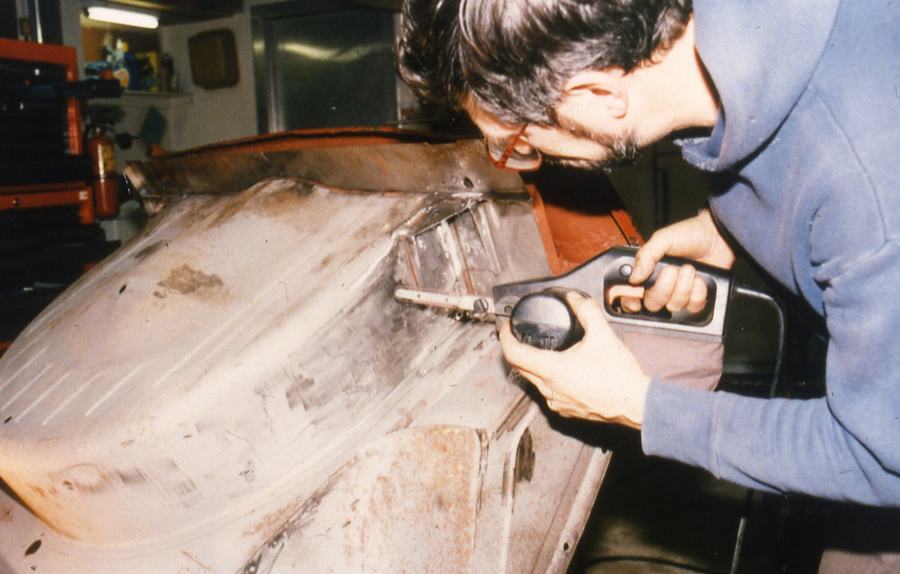

I bought my first one on a trip to Germany. It was a Black and Decker, ran on 220 volts and was made in England. I've also seen them in Canada and USA. The one I have now is one I bought in Canada and is driven by my air compressor. I think Harbor Freight might have them. Much cheaper. Here I am in 1988 doing the rear clip under the rear valance with my Black & Decker electric driven unit.
