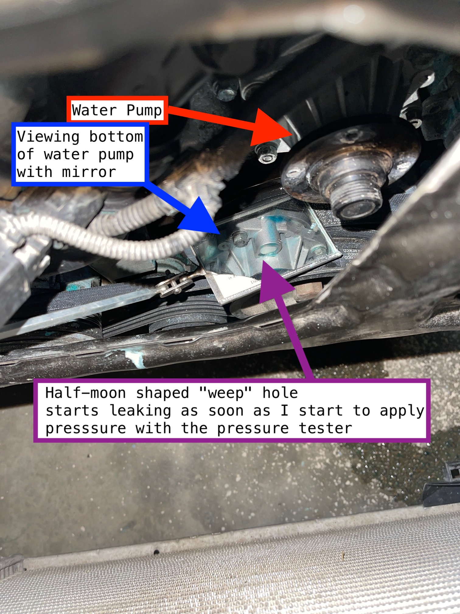

I may have a bad "new" water pump. (By the way, this pump only has a large circular rubber seal that sits in a groove aft of the impeller - there is NO gasket for this water pump).

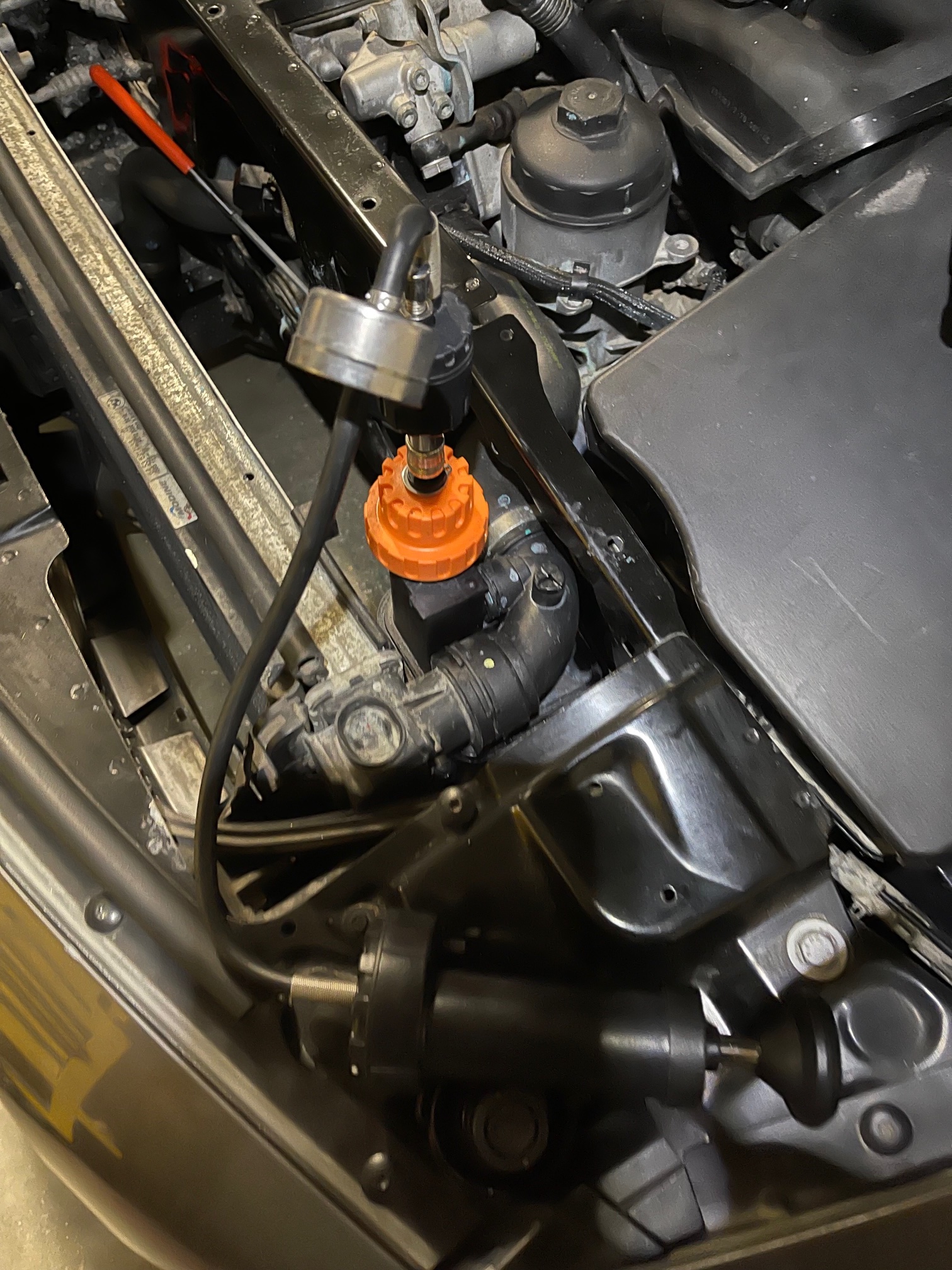

I got a loaner Coolant Pressure Testing kit from Auto Zone ($250 deposit). I removed the front pulley and electric fan on the car to allow access to the pump. Then I stuck a mirror under the water pump. I started by thoroughly cleaning off the coolant from the bottom of the pump. Whilst looking at the bottom of the pump I began to pump the tester to apply pressure to the system. As soon as I started getting some pressure in the system, but well before getting to max specified pressure, I could see coolant begin to come out of the little half-moon weep hole on the bottom of the pump. Now, I know that some coolant out of a weep hole is to be expected but this seems excessive and was getting on the belts when the car was running and thus coolant was being flung all over the various front components of the engine. By the way, the weep hole on my original pump was much smaller - maybe 1/32 inch. This "weep hole" on this (after market) pump is much larger.
By the way, the reason I got this You can see from attached picture where the leak is coming from. From looking at the design of my original water pump (and this one is very similar except for the location and size of the weep hole) it would seem that for coolant to be leaking from the weep hole, it would indicate that coolant is getting past the seals in the impeller. This makes me think that perhaps I got a bad "new" pump.
Thoughts or suggestions?
Coolant Pressure Tester
Looking at underside of water pump as pressure is applied
Ok, I just read this disclaimer on the page for the pump I bought: "Every belt driven water pump has a weep hole that might leak a little in the beginning. Some seepage from the weep hole is normal during the break-in period (about 10 minutes), and does not indicate a defect."
So, maybe I don't actually have a problem? Think I'll button it up and drive it a bit longer to see if the leak continues or slows down/ stops or gets worse.

Well, the conundrum is this: When I first replaced this water pump, I took the car to BMW to have them pressure test the cooling system as I knew I had leaking from somewhere but could not tell from where. This involved a drive clear across town (about a 40 minute drive). By this point I had installed a new WP and new Thermostat/ housing and new upper and lower radiator hoses. The BMW dealer reported at that time that the water pump, the thermostat (and housing - all one unit), as well as the plastic heater pipes that run under the intake manifold were all leaking. So, I bought a new WP seal and a new Thermostat gasket and pulled the WP and Thermostat and replaced the new seal and gasket. I also replaced the two heater pipes (these go from the front of the head and run under the intake manifold. These are a bear to change as you must remove the intake manifold (a $2500 job if the dealer does it). I also installed a new expansion tank since the car has high miles and these are prone to failure.
Long story but the gist of it is that this WP has been run for much longer than 10 minutes and is still leaking a good amount from this weep hole. Given that it is such a pain to replace and I have most of it apart now, I think I'm going to go ahead and get another new (but different brand) water pump and go ahead and replace this one while I have it all apart.

I bought it from Rock Auto. Beck Arnley with a metal impeller. I bought a AC Delco from Auto Zone and replaced it tonight. Fingers crossed but so far no sign of leaking.
The guy at AZ right away said I got a bad seal from the factory. Said it’s happened to him a couple times (this guy is actually very good and is the one guy I always look for when I have a technical question- he really knows his stuff)! Anyway, I’ll take it for long drive tomorrow and check for leaks. If none (hope) I’ll button it all up and call it good.

Don't know how much yours is "weeping", but I first learned about weep holes when I replaced the pump on my ol' Mercedes. And it did indeed weep a bit when first installed. Is the weep hole where the coolant is coming from?
(And Rock Auto has an *excellent* return policy. Ask me how I know!)
A look at the last photo in Basil's post {#10) tells the tale. An internal shaft seal likely the cause.
Thanks. I'm thinking that's the largest weep hole I've ever seen on a pump. Maybe the hole itself is more a "pinhole" inside that half moon?
