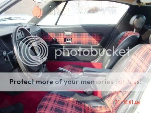

I guess plaid can go either way...
I LIKE IT!

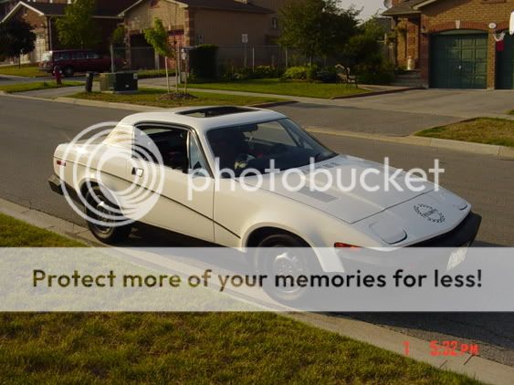

The one that shouldn't have gotten away:
Thomas is on the correct path with his choice.
