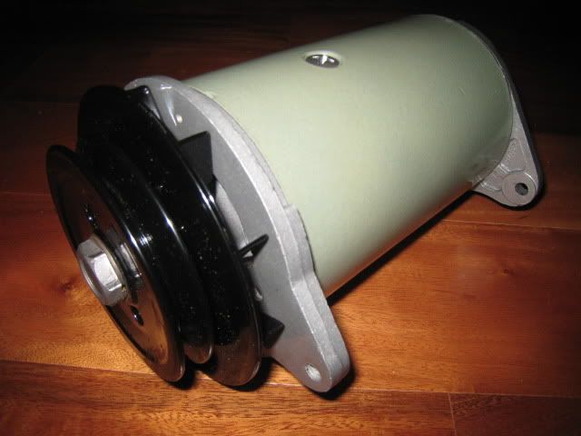

Just completed rebuilding a generator for a local car club member. All parts came from MOSS (I ordered just about everything on page 87 of their catalog) and incl. shipping cost $52.40.
