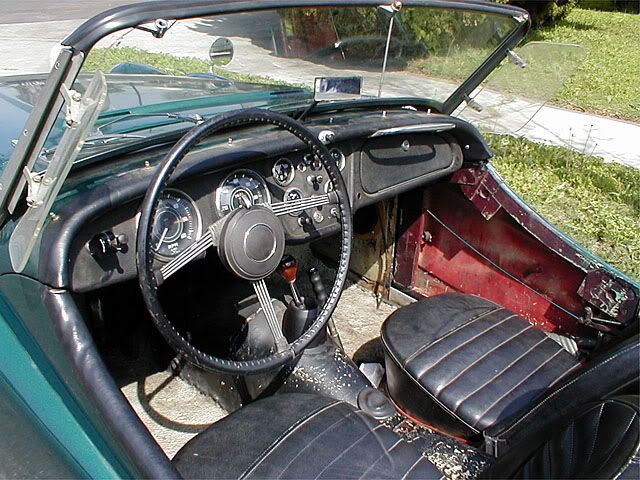

Many cars had it over by the corner of the cubby box. You can see the empty hole in this shot of TS39781LO
P3170011.jpg~original
But it was apparently usually a dealer-installed item, so they might have put it anywhere.
