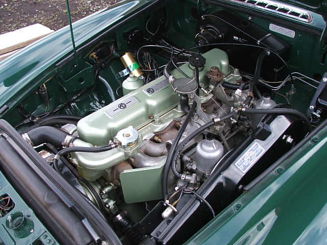

Ooo a carb cooling fan? Sounds intresting, never seen that on one over here...has some got a pic of it or the engine bay of an american MGC?

Mg_Bizzle said:
I hope to get the MGC bonnet for my car, fibreglass version obviously.
This is the engine bay of my 1968 tourer. The brake boosters (North American market used two opposed to one in the UK) are packed up and ready to go to Power Brake Exchange for a rebuild.
You can see the temperature sensor for the carb fan just forward of the air filter housing. The actual blower motor sits in behind the grille and in front of the radiator shroud.

The engine appears to be painted AH green... Is that the factory color. It does look a whole lot better than the MG red.... /bcforum/images/%%GRAEMLIN_URL%%/smile.gif
