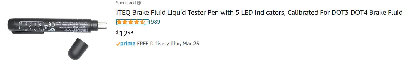

Pretty hard to get air in the sealed brake system. The most common reason for a brake flush is that DOT 3/4 fluid is hydroscopic, so it can absorb moisture from the air which will degrade braking ability. You can't tell that unless you actually test it though, which is really easy.
In the shop I used the one below, which measures the electrical conductivity of the fluid. More water better conduction. Easy gauge
to read, and much better that the old test strips and........cheap
