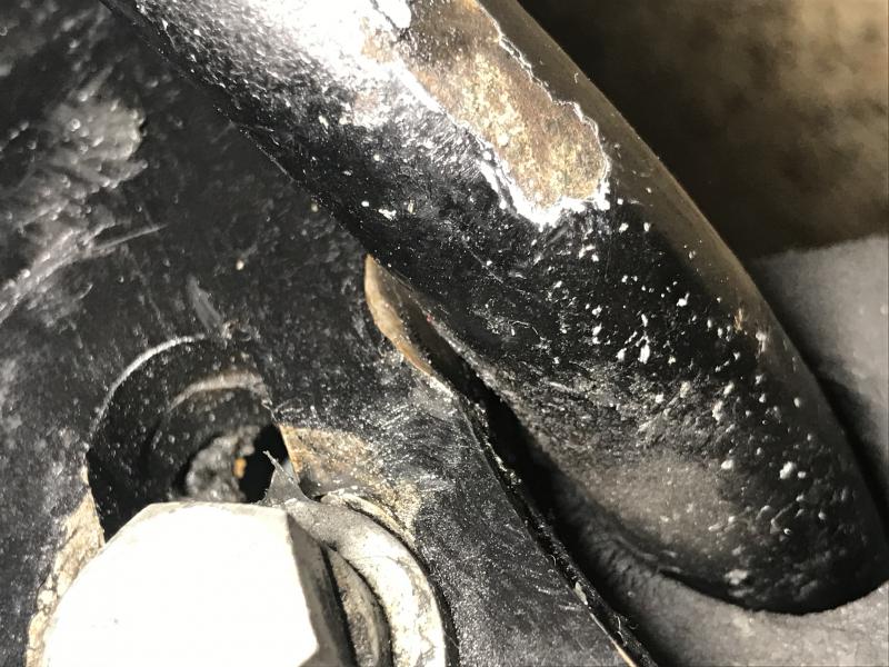

I noticed the sway bar's end travel is hindered (on both sides) by the spring bar assembly. It's denting it.
What's the best way to correct that? Could I place a shim under both of the sway bar bushes to allow more travel?

Hey Bob, there is no adjustment for clearance. The bracket has oblong holes which lets it slide forward/back only. The bracket needs to be higher. Adding shims to lower the sway bar seems to be the fix. I'm wondering why I have this issue if most do not.

While you're at it, check to see if the metal strap of the mounting bushing is bent. In your first picture above, the outer flat part of the metal strap does not look to be parallel to the bar like it should be, and the bushing looks like it is distorted some. Could just be camera angle?
While you're at it, check to see if the metal strap of the mounting bushing is bent. In your first picture above the outer part of the metal strap does not look to be parallel to the bar like it should be, and the bushing looks like it is distorted some. Could just be camera angle?
I appreciate your eagle eye. I'll make sure it's not bent and straight. I'll post some more clear photos. Thank you.
Are the ends of the anti-sway bars horizontal, or do they rise as they go to the end links? Compared with the bottom of the frame, it looks like it turns up. You might have to have longer end links. I made new, longer links using a 6" grade 8 bolt and 1/8" pipe for a spacer between the inner bushing washers. Also, the bushings look distorted.
You said you replaced the bushings with poly about 6 months ago. Those sway bar bushings look like rubber... not poly. They look distorted and cracked.
From the pic above, besides being stressed rubber as Richard says, it looks like the front of the frame rail may have been bashed in. If so, an adapter plate could be made to move the sway bar out away from the bumper mounts.

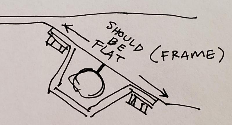

If it's flat like this dwg, just shim it enough to get the clearance you need.
Sorry, I didn't clarify when I said I replaced the rubber bushing. I replaced the eight anti-roll bar link assembly bush links, 6 months ago with polyurethane. I need to replace the center sway bar rubber bushes.
Practicing your engineering drawing skill I see. Nice.
As pointed out, because that area is dented, I've made plate shims out of stainless. I'll end up with a flat mounting surface, like it's suppose to have.
