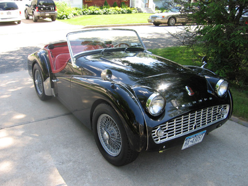

Chrome wires look great, but Man, are they a PITA to clean and maintain. I replaced the ones on the Stag, because they were "original", but I wish I'd gone for alloy wheels instead.
Don't forget you have to shorten the studs when installing the wire wheel adapters; then replace them if you decide to go back to solid wheels.
The wires should also be serviced annually, which means at minimum taking them off the car, cleaning and re-lubricating the splines and threads. I didn't do that on the Stag, and when it came time to change tires (on the way to VTR 2005 some 700 miles from home), we almost couldn't get the spinners off. Had to work in shifts, beating the crap out of them! In extreme cases, I've seen them cut apart with a torch (which of course means a new wheel & adapter).
