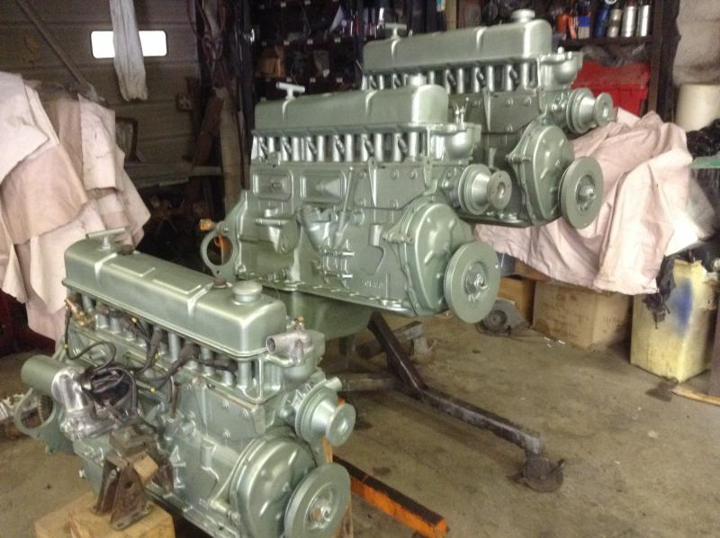

Must be the water. I built three engines at the same time in 2016. All BJ8 motors. First one I installed ran about two hours total. It made awful knocking noise after a ten mile drive. Installed second one in my brothers 57 100/6. It ran fine, it was built 40 over and some kind of high lift image.jpg cam. Put the third one in the BJ8 that the engine knocked. Its running fine. Have not pulled the first engine down yet to see what the problem is.
