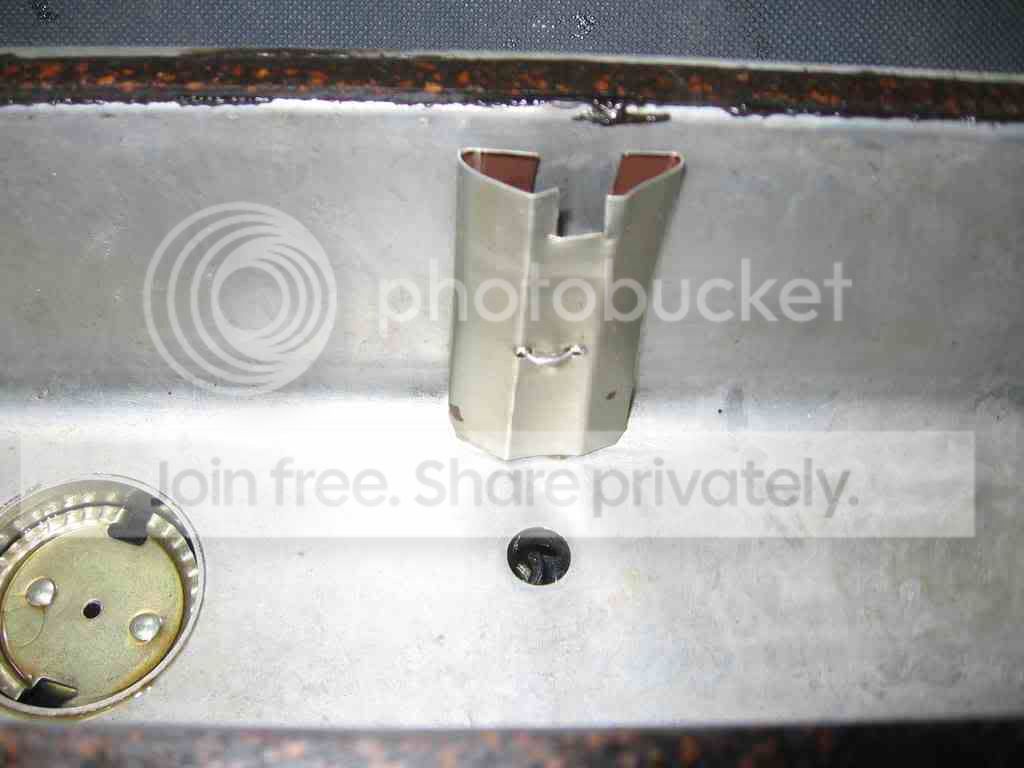

OK.... so Ron, just so you do not have to continue to have that new alloy cover collect dust, here is what I did.. (sorry not sure how to put pics right in here).
https://s270.photobucket.com/albums/jj97/ickard/Valve cover oil baffle/
It has been on for 2 summers now and I am not worried about it comming off or loose. It has to be very flat so as not to come in contact with rocker assembly.
It also must be full height of inside wall and only a hole at the bottom.

Casey, a slight misunderstanding. I have had the alloy valve cover on with the baffle for 2 years. The extra oil feed line has been on since I completed the restoration back in 2001.
Sorry guys, I will have to learn how to put a pic right here. Sounds like I need a personal WEB page to do it. You can do a copy and paste of the HTML link into your browser and it will go to my Photobucket.
I admit even with the baffle I have made, there is still a very small amount of oil getting past. My first attempt had more "holes" in it so I re did it with just a small cut out and at the very bottom. This drastically reduced the amount. It is very important to have the baffle go to the top (full height) of the valve cover.

Testing 1 2 3
Wow it worked.
I do suggest you go to my Photobucket page to see the rest of the pics on how it is fastened to the exit pipe.
I guess I need to make the pics a little smaller:)
Rickc

It looks like Rick has found a way to beat the $139 oil separator blues. And my oil pan is drilled and fitted with bungs on both sides in case I decide to go that way.
Rick, now that I re-read my reply, I want you to know that I did not mean to come off as a twit about it. I was sincere about you finding a way and it looks like you did.

Can't see the picture.
How is the engine operating? That should answer your question.
Ron if you are talking about not see the pics at my photobucket site.
then make sure you are looking at the album labeled "valve cover oil baffle".
