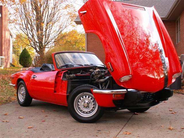

Now, NONE of this applies to my TRs, the finish is just not close to that good and I doubt that Triumphs ever produced a paint job worthy of this wax. For the TRs, I take the same care of the finish but use Griot's carnauba ($20)and apply with a wax pad instead. But the principle applies. SO IMO a polisher has it place in correcting imperfections but to keep a finish looking (and feeling) great, it just takes work ... or devotion.
