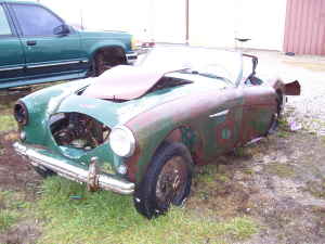

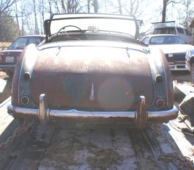

Here is a pic. Build plate appears to be original. Says "Austin of England on the deck lid. Hope someone can ID it for me.
Thanks
Steve

stevebn2bj7
That helps a great deal. it is an early 100 likely a 53 or 54. There seem to be a lot of valuable parts there and it is very restorable by an experienced person. May not make financial sense but it is doable based on this one picture. If you don't buy it I am sure I would or someone else on the forum would.
zblu
I believe the 5141 is the body number and the 6834 is the jensen company batch number, the earlier cars had the A of E badge on the boot lid, later ones had AH, on the rear shroud are there holes for the later fitted indicators?, and if you pull off a wheel are there 4 or 5 studs holding the wire extensions on?
You'll find Anderson & Moment's book useful.
If 5141 is the body number, they show 5001 built in September, 1954 and 5746 in October, 1954.
Once you have the car an exact build date (and other information) could be found from a "heritage certificate" from British Motor Heritage Industry Trust

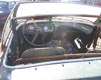

Here is the builder's plate. Maybe installed by the dealer?
Steve
Looks like an early BN1. There should be a plastic plate in the passenger side footwell that has the cars vin number.

Hey it has its instruments (plus a couple extras), steering wheel, turn signal switch and boss, all look intact and restorable, that is good, as that stuff is generally not available new, lots of light seen through the lower right passenge compartment, not so good.
It looks worth fixing up to me, but hey I love these cars, and they are worth it both from driver enjoyment, looks and yes if you decide to sell they do pretty well on the market restored or even in good driver condition.
Have fun, keep us posted with progress or questions.
Lastly, I think that plate from the Texas guy is a later add on, noticed there are two extra guages (upper right) the car doesn't usually have, perhaps that and some other work was done on the car by Foreign Motor Service when the car was younger.

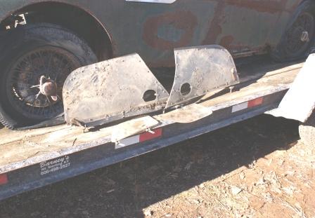

well well well, lookie there, original perspex sidescreens. Those alone are probably worth $1,000. I wish I had a set.
