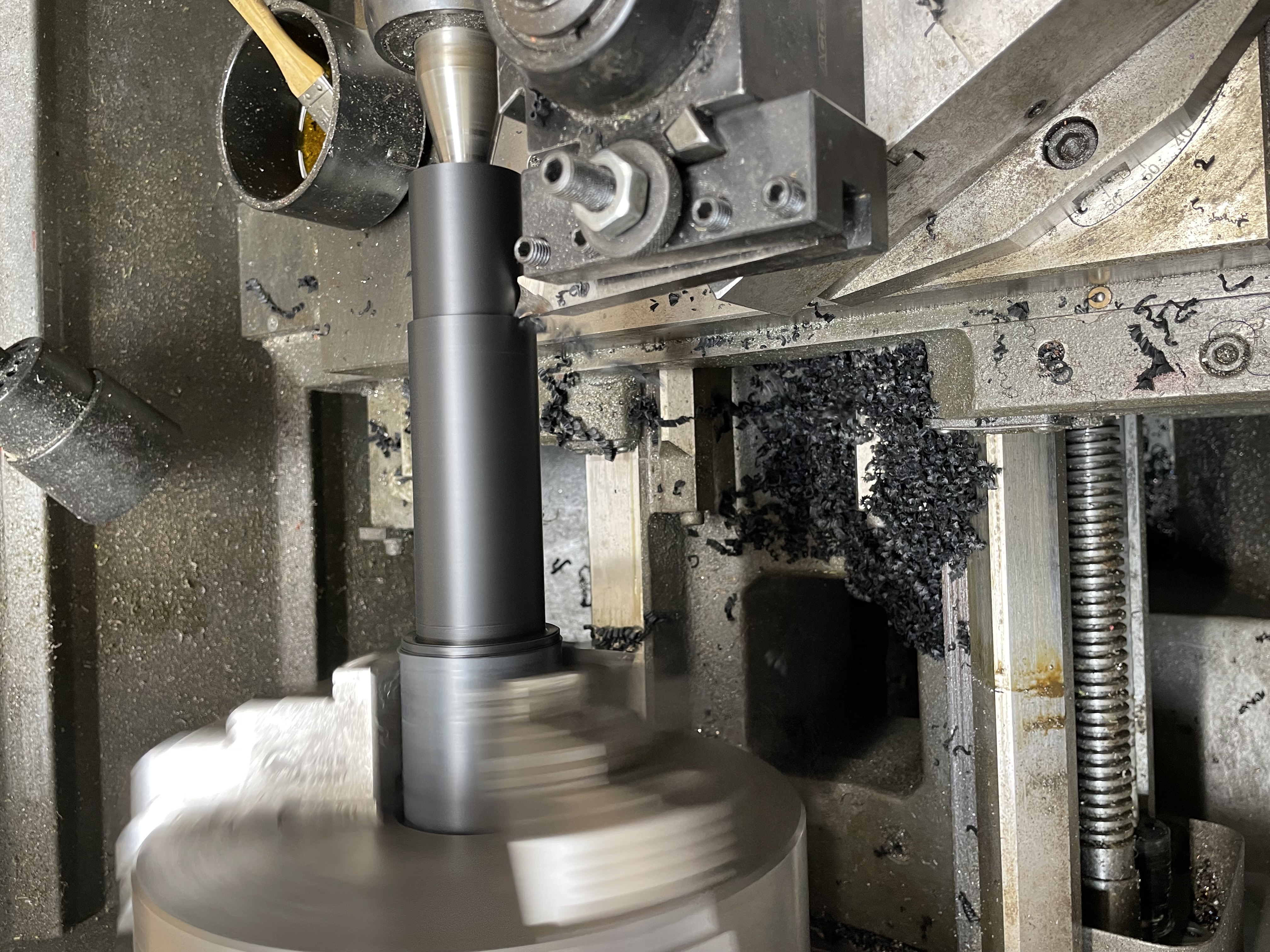

I’ve got the equipment… I think…
Got a heavy duty press, and a couple nice lathes…

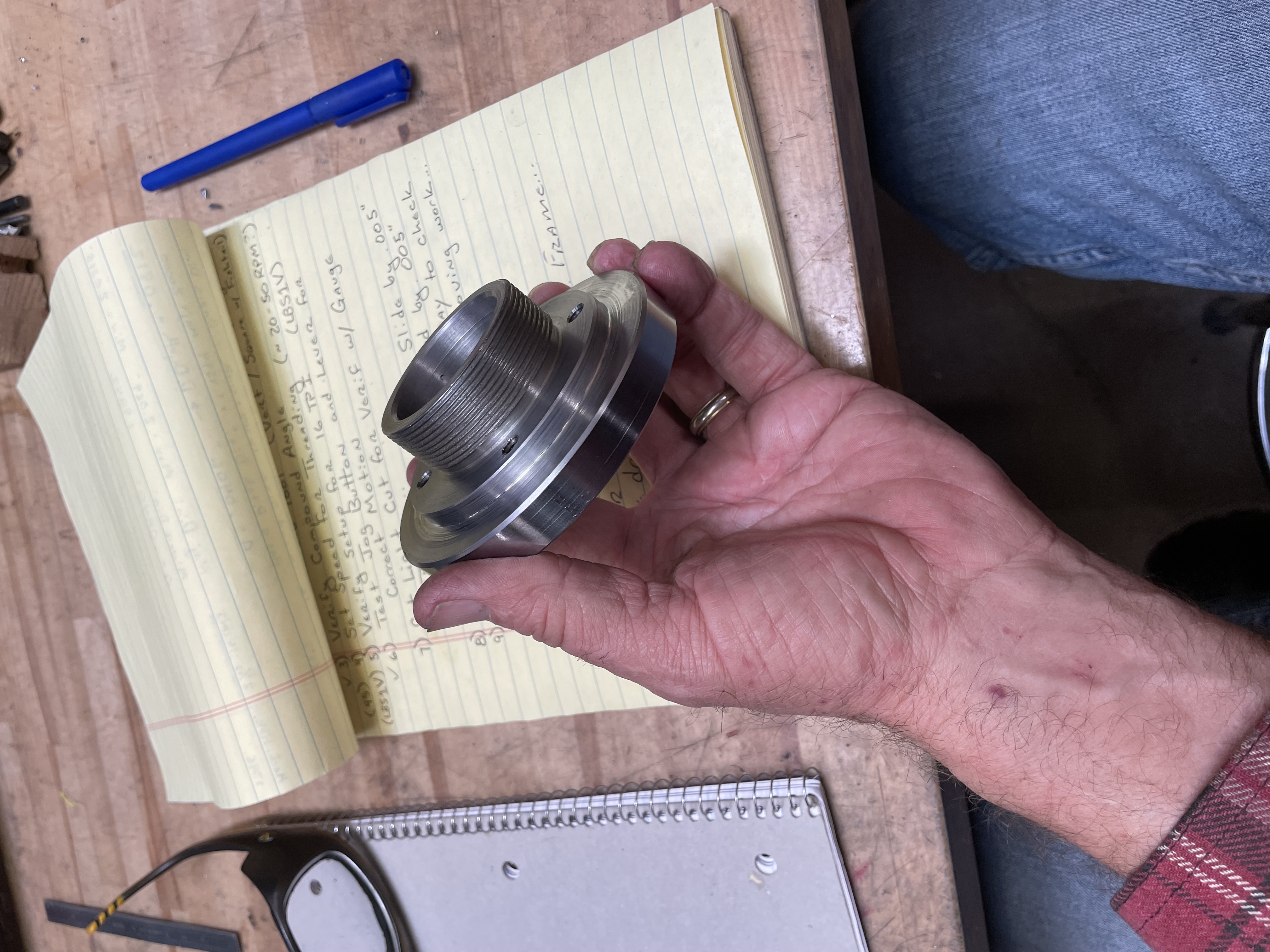

Just made this hub…

Original hubs are very weak. Nice work on that one. Be careful removing them from the quill shaft…they usually come off with a big boom.
Watch out for damage to the quill shaft threads and nuts. Would have the quill magnafluxed before doing much.
It can sometimes be a bit of work to remove the lower shaft that gets attached to the upright.
I do have some spare bits here if needed.
Usually make the crush tube out DOM.
