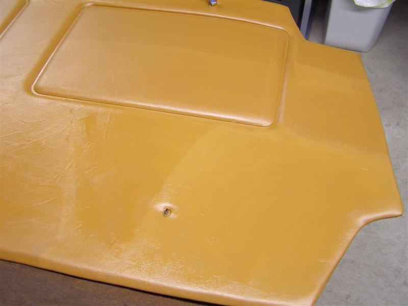

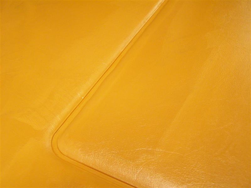

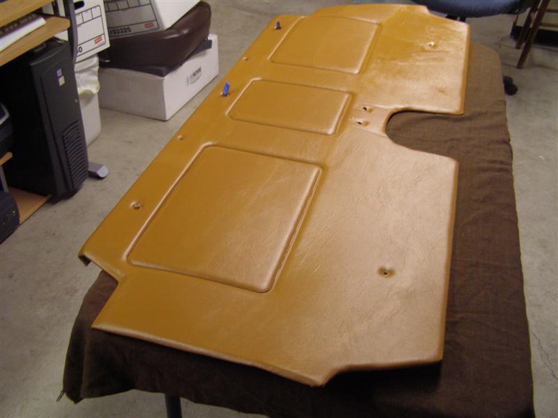

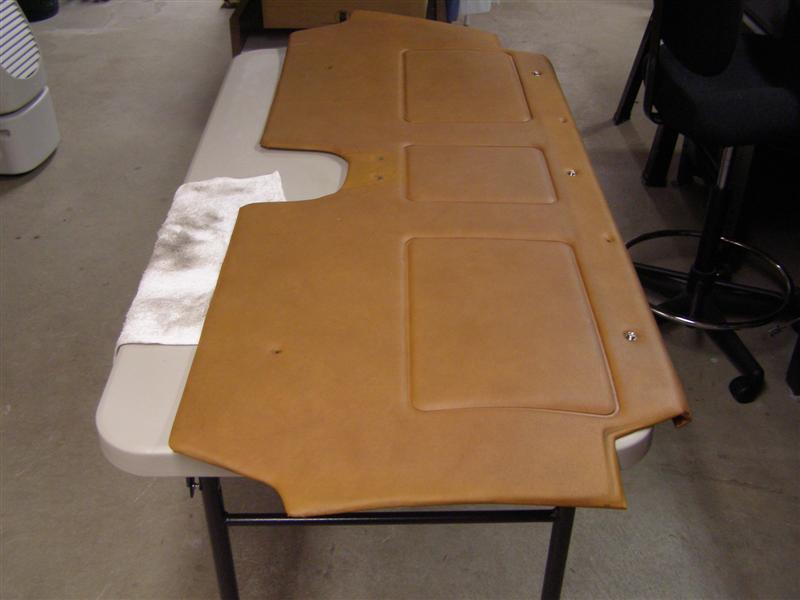

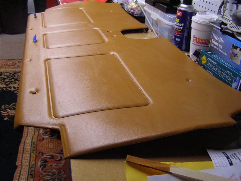

Your interior looks great. I have included some shots that show a before and after cleaning, the cleaner that I used (before a quick drying body wash right before application) and the boot cover which is much lighter than the tan interior that I want it to eventually match.
By "CRISS CROSS" do you mean an "X" pattern, by going back over what you have done?
Thanks.....
For some detail, #1 was before cleaning and you can see the fading, #2 was after one cleaning, #3 was the cleaner used, #4 was after the second cleaning and how much dirt that gets baked in came off on the towel, #5 is the material to be applied and #6 shows the boot cover and the trim color difference that I want to become the same.
First I'll do the rear panel and next will come the cover.

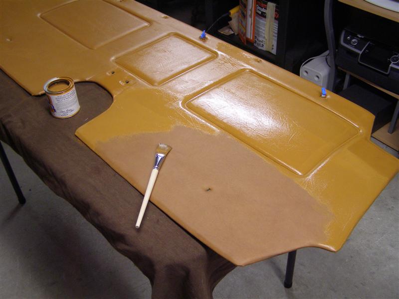

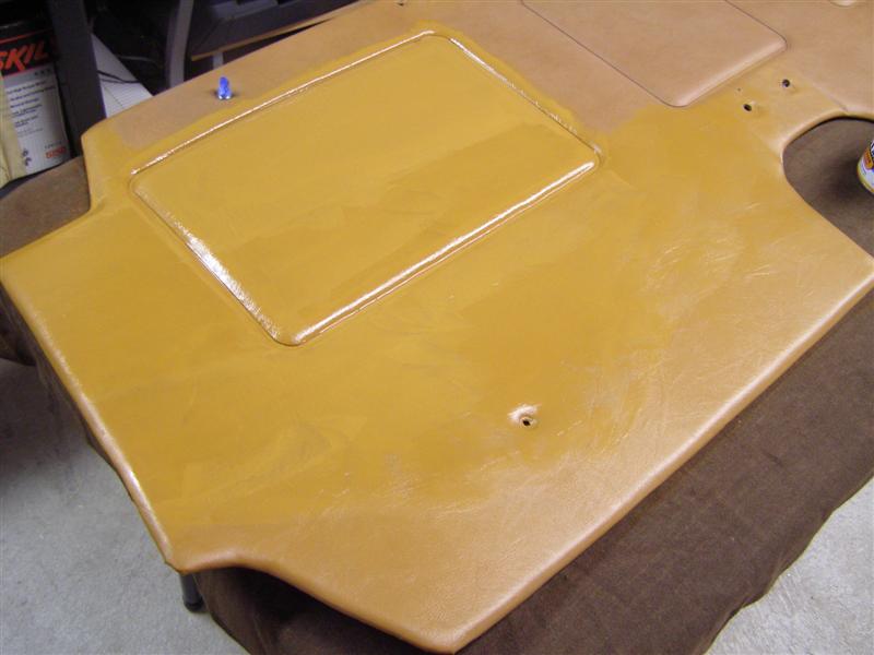

Russ,
One last question. How long did you let yours cure before handling?

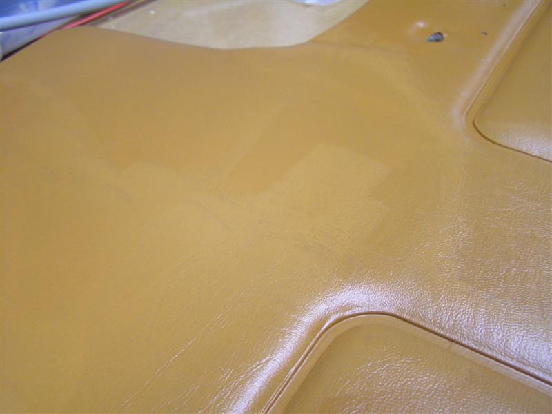

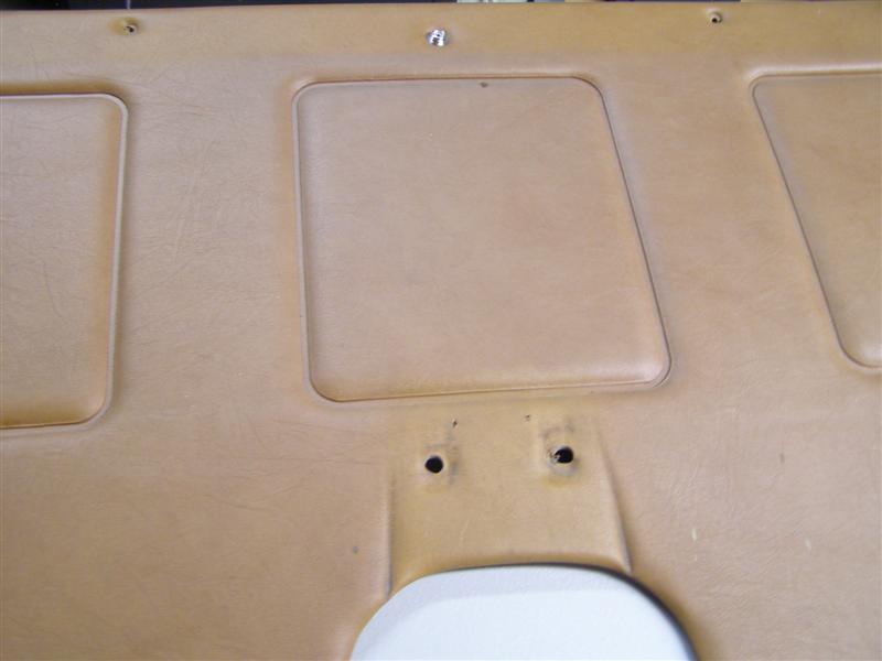

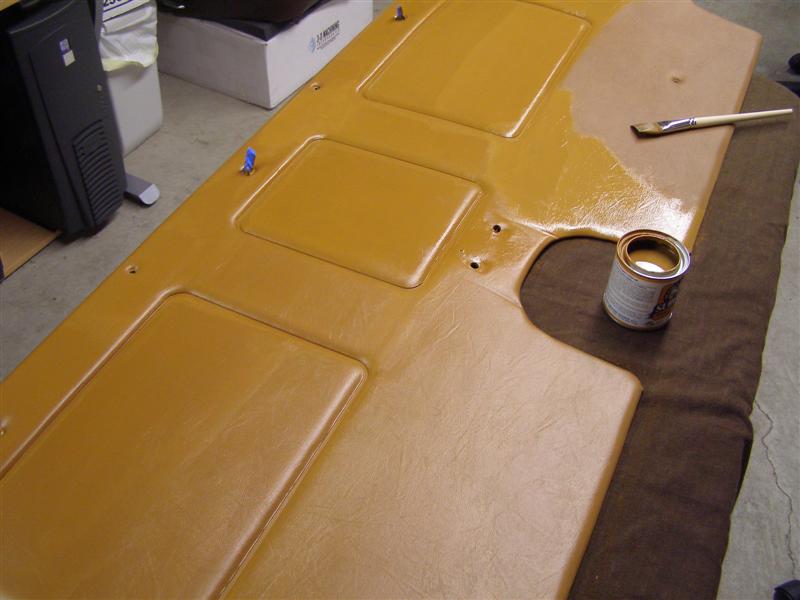

I answered my own question when I read the can again and started the application process. I did one final cleaning with a body wash just to be sure that I got the remaining silicone or oils off of the vinyl.
I started in the lower left corner and worked my way around. In hindsight, if a big flat panel like this can be sprayed, that would seem to be the ideal way to do it. I did my best not to go over previously done areas, but it's hard on a panel of this size, with few break patterns to do the wide open spaces without blending a bit.
We'll see how it looks after drying later today and tomorrow. I'm hoping that my results are equal to Russ's and that it all evens out.

Howdy Paul,
"CRISS CROSS" brush strokes like an "X" pattern is correct. Of course; You`ll always probably go over a bit of what you covered but it surely won`t hurt anything. Just think like your painting something "ABSTRACT". Go with the Flow.
The main reason for "NOT" going over the area which you have already applied the dye is simply not to have "TOO MUCH BUILD UP" and If you do; It may bubble or peel. Your certainly better off with a "LIGHT 1st COAT" appl. & "IF" necessary; Your "2nd" coat will fill in the gaps.
Due to the fact that your basically applying a similar color; You should be just fine with one coat.
By the way; This dye goes a "Long Way". My Bugeye had a "Black" Int. & as you can see; I changed "EVERYTHING" to "RED". That took 2 coats & still had some left over.
I let mine dry overnight (24hr period).
I just thought of something. "DON`T STIR" the dye like you would normal paint. That creats "Air Bubbles" in the dye & You don`t want that. Also; The "3 Clips" on the lid; Make sure you save those cause after re-using the dye; Those clips create an "AIR TIGHT SEAL". "NO BUBBLES" & of course, store in Room Temp.

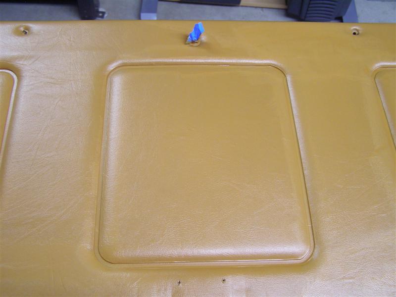

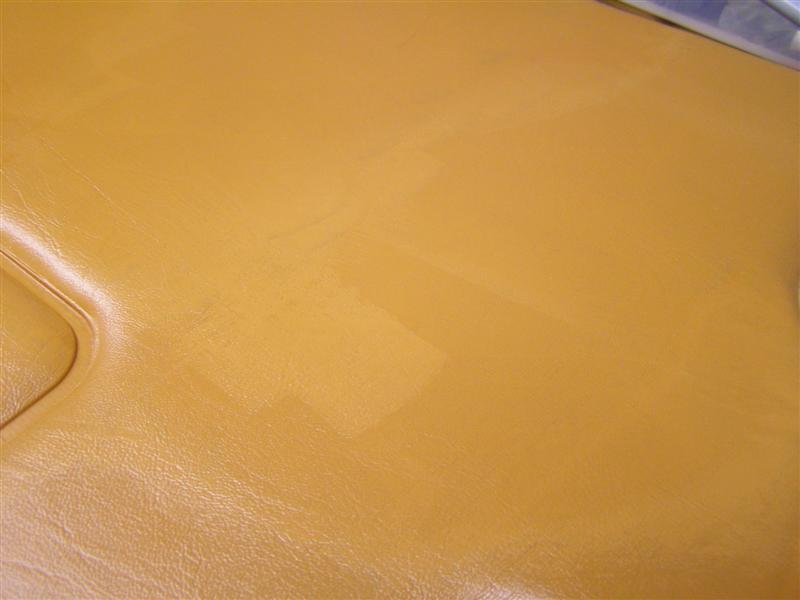

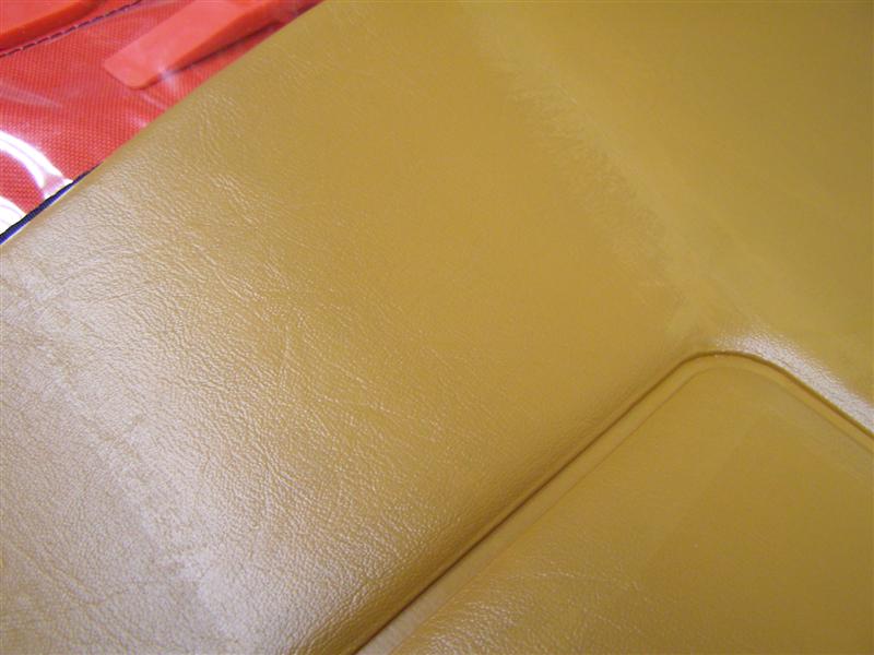

Russ,

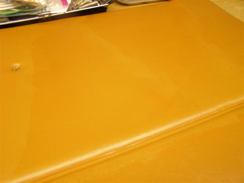

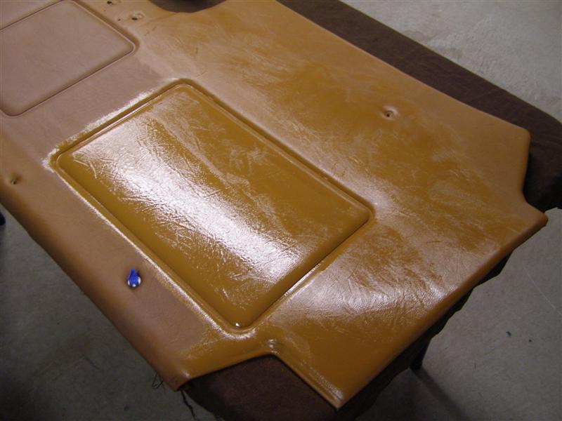

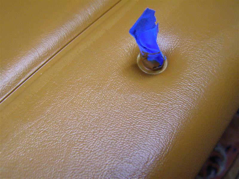

It didn't come out as well as I would have liked. I did email Joanne some pics, but the differences in shades that you can make out in the pictures above, did not go away after sitting overnight. I may have to do a second coat, but I'm going to wait for her evaluation before I do anymore. I will need a lot to do the boot cover and I'm hoping to have enough in the pint to get it done after doing the rear panel.
I'll be posting more back on this. And on another note, I stopped by Eddie's to check on the visors. They look great!! He was clamping them to form a uniform pattern around the bar that attaches into the center holders mid windshield. They are custom stitched just like or better than factory units and the trim is what I used for the color for the rear panel, so it's all going to match a lot better.
I told Eddie that I'd pick them up late Monday, so I'll start a new thread for that project.

Hi Paul,
Thats a surprise posting to me! When you did the cleaning prior to dying; Did you wait till the panel thoroughly dried?
Something is wrong there but I`m sure Joanne will be able to make some professional suggestions. Certainly; The 2nd. coat should do the trick.
How Happy are you with the color match?
Regards, Russ
PS: Say "Hello" for me while your talking to her.
Russ,
The color match is fine and it's more like the long camera shot of the entire panel in real life. Different angles make it look different.
The panel dried for two full days in my 75 degree 50% humidity basement, so I know it was dry and the wax remover was applied , wiped off and given an hour to dry, so I know it was fine.
I think that the panel will need a second coat and I'll use a larger brush, or maybe wipe it on, depending what Joanne says to do.

Well, two more coats and I either end up with lines or streaks.
Next move may be spraying. I even gave my wife a brush today and we applied it together to try to beat the drying ans subsequent lines and now I have streaks. AARRGGHH!!!
It maybe time to spray this thing. But I think I'll call the guy at the Lincoln dealership to see who does their vinyl repair and give him the dye and let him shoot it. I don't want the mess in my basement.

Russ,

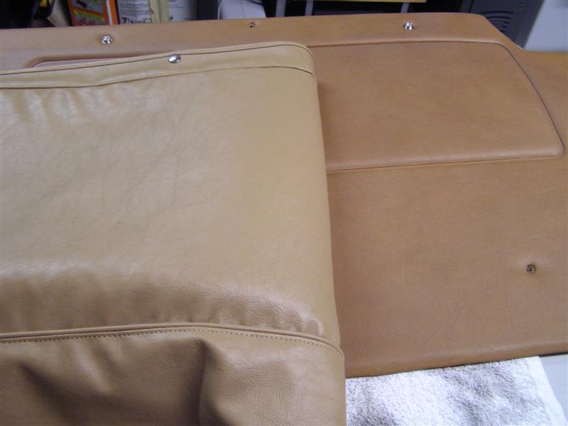

It's not so much that it's streaky, but rather there is no way to blend it without getting into a "brush over" of a dried or partially dried spot and you know what that means. most of it looks great, but I just hate the seams, for lack of a better word.
I dropped it off at my buddy Al's A& E Auto Body. He's going to spray it for me today or tomorrow. That should fix the time of drying in sections problem over the large area.
He is meeting with his paint supplier today for an idea for the convertible boot to make that easier, as it's another big piece with long panels to blend. More on that later.
Just for the record, I am very satisfied with the product and Joanne and her help. I just think that panels this big need to be sprayed to look perfect.
I think the problem will be solved by Friday. My buddy Allan at A&E had the DuPont rep in today. they took a color swatch from leftover material from the visors to run under their computer analyzer and matcher. They mixed and delivered a pint of their product (which I don't really know what it is) and Alan will spray it tomorrow.
