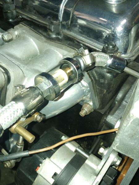

So a fellow club member loaned me his original AC fuel pump that he removed under suspicion of an oil leak. After I installed it, and made a new cork gasket for the bowl, I tested it by running the engine until the temperature was normal, then shutting it off, closed the hood and let it sit for 5 minutes. I also changed out the filter element. Here is how the AC pump performs on the warmed engine: https://youtu.be/QgvrkYOxTlQ The next time anyone tells me 'there's so much room under the hood, it must be easy to work on', I will know that person never changed a fuel pump on a TR3 while the engine was in the car.
I don't think either fuel pump is bad. I don't think the invisible fuel in my filter is a problem. -But I still don't know what to think.
While I was changing the pump, I removed the vice grips that were used as a clamp on the fuel line from the tank to be sure a constant stream of fuel was available by gravity. My old fuel pump glass bowl had a little debris in it, but nothing serious. The in-line filter also showed some signs of working, but not enough to clog it.

If you mount a filter horizontal it will always and a day retain a large air bubble. If it bothers you, then mounting the filter vertical with the inlet down will get rid of it. It's like trying to fill a cup holding it sideways.
John, perhaps you missed my statement in post #7 where I changed the filter from horizontal to near vertical. I understand the analogy to the tilted glass. True, the bubble almost goes away completely when the filter is tilted. What "bothers me" is that the bubble is gone when the engine is cool, but reappears after it has been warmed up, and then disappears again as it cools back down. Actually, it doesn't bother me at all, but I can't explain why the filter appears empty (when the car is warm) and everything is working normally (and refills simply by cooling down).

That would lead one to believe the bubble is actually fuel vapor boiling off. Once it cools below the boiling point it is condensing back to gas?? Maybe the gas blend has components with different boiling points, so only some parts of the fuel is boiling off?
That would lead you to believe the fuel may be right on the verge of vapor lock in normal operation??
Just rambling guesses...
When I was having the running issues with the first set of SU's that I installed, I was running with a glass filter just before the carbs. It would do exactly as you describe....run with a full filter and then over time, the filter would empty. However, mine would eventually stop and not continue to run (this was with the previously mentioned troublesome SU's that I had installed). If you recall, at one point I thought it was the fuel pump as well (because of the empty fuel filter) so I changed that for another fuel pump with no change. When I started looking at the possibilities of vapour lock, and possible sources, I made the decision to remove the glass filter before the carbs as I thought it might be soaking up some heat. I did all the other stuff like checking the fuel line routing and adding small amounts of insulation here and there along the metal fuel lines.

OK, this may sound a little crazy. I know at least one person on the BCF who constantly recommends removing the fuel filter. I tested my fuel pressure yesterday and noticed something I'd never seen before. The bubble of air in my in-line filter went away. The bubble was always about 1/2 of the filter. It seems I installed the filter perfectly level, and near the carbs such that some of it is higher than the carbs, and the bubble always filled the top half of the filter. I looked back through pictures until I found a picture where the fuel level can be seen, just after I shut off the engine, shortly after I installed the alternator.
So, I've been thinking about how air expands when it is heated. I looked up the Rayleigh-Plesset equation for bubble dynamics and found it much too deep for my understanding. But I can't help wonder if my bubble had an effect on my situation. In any case, I altered the arrangement so my filter is tilted, and the bubble is minimized.
My fuel pump provides over 2.5psi. The pressure is held to 2 psi for over an hour after the engine is shut off. I have often found the most complex problems require a very simple solution. And often the simplest solution is just a prayer. I wish I knew a way to simulate my car dying when I least expect it.
Just out of curiosity, ( as my set up is very similar to yours, though I use an electric FP & pressure Regulator set to 2psi).
i put mine through your test. Started with the glass filter about 2/3 full. Took it on a spirited 30 minute drive, then let it sit at idle for 10 minutes or so & got the temp up. Checked the fuel filter & there was very little fuel to be seen, except a minimal stream in the bottom.
also I did a thermal check throughout the fuel line. Nowhere did it top 190, in fact it wasn't even to hot to touch, even at the closest point to the valve cover, with the ss jacket.
means nothing really, except it points out this fuel filter operates like yours does, so it may not be your issue.
