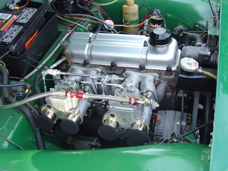

I realize that you are probably not using webers, but this is what I used on my TR3 for fuel lines along with an electric fuel pump a fuel regulator and an electric fan. I never had an issue with vapor lock, over heating or fuel delivery problems after installing this setup no matter how high the outside temp was or how fast I was going.

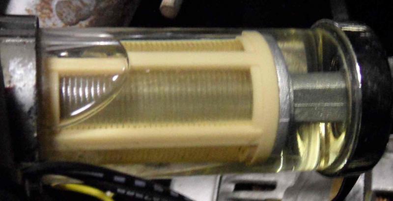

The plot thickens. Or is it just the fuel returning to a liquid state?

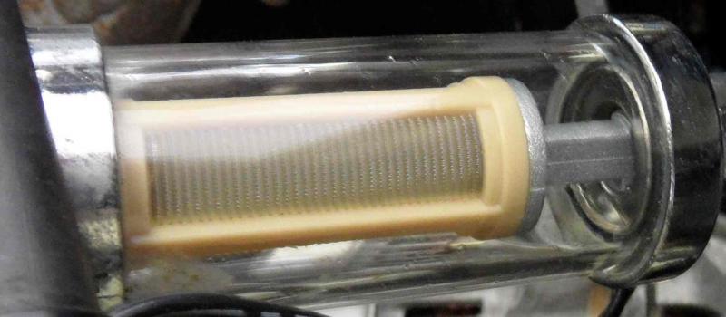

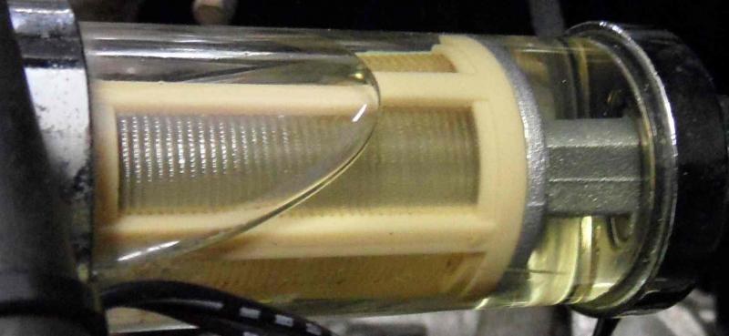

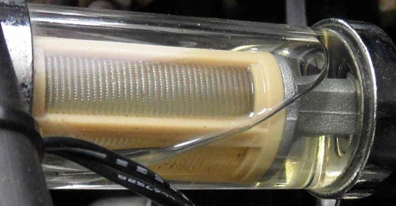

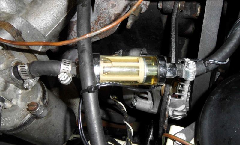

Today I drove the TR3 less than 2 miles to the cleaners, picked up, and returned to the garage -a little longer than required for the temperature gauge to be at the center point. The car started, restarted and ran perfectly but I opened the bonnet in the garage just for fun. I was stunned to see the fuel filter completely empty. I thought perhaps I stumbled upon the condition to create vapor lock. So I turned on the key, and hit the starter and the engine sprang to life as if it were warmed up. I let it sit and idle for at least 10 minutes. The filter remained empty, with occasional squirts of liquid fuel entering the bottom of the filter. It never stumbled or hesitated when I accelerated. It shut off without run-on. Just for fun, I opened the top of the front carb bowl, and could hear the pressure releasing as the float dropped. But the filter still appeared empty. I (re)secured the bowl cover, and restarted without hesitation, and verified the empty filter. After the electric fan cycled several times, I shut it off and took some pictures of the "empty" filter for the next couple hours.
At first (3:23pm) it appeared completely empty. An hour later (4:16pm) I could see liquid in the bottom. Later (5:01pm) a little more could be seen. Later (5:30pm) a little more. After 3 hours (7:00pm) the engine was warm to the touch and the fuel filter was nearly full again. I don't think the ambient temperature got over 93F today.
I don't understand why the filter appears to be empty, but the engine runs normal and the bowls are full. I don't understand why the filter refills itself, unless the fuel has changed to gas when heated (transparent), and returns to liquid (translucent) when cooled. I have another fuel pump that I can put on, but I am unsure that is going to keep me off the side of the road.

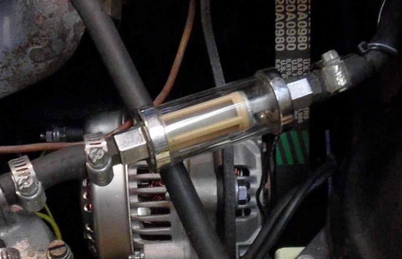

That's wild. I have no explanation for that one; never heard of an engine that would run without a fuel supply. It might well start on what was in the bowls, but something had to be refilling them to keep it running. Hard to believe the fuel was boiling (turning to vapor), going through the filter, and then re-condensing before it got to the float valves!
This is just ordinary, local pump gas, right? Not Av gas or bought in Canada, anything like that?
On a totally unrelated side note: are the end pieces of that filter plastic? It looks very much like one that a friend had on his TR6. Driving down the road, the end piece on the inlet side cracked and started spraying fuel all over the place, even though the engine stayed running.

I would replace the pump, it sounds like it's pumping fuel most of the time but pulling some air in every once in awhile.

I can't say I am 100% convinced this is even a fuel problem.
Intermittent heat-related failures can be very misleading. The engine quits... you check things... you do 'something'... the engine starts again. It is natural to assume that whatever you futzed with while sitting at the side of the road was the cause of the failure - but in some cases just sitting there with the bonnet up for a few minutes is what made the difference.
I'm not saying it cannot be vapor lock - but were it I, I would try to recreate the problem (in a more friendly environment than a freeway median) and start checking everything (e.g. content of bowls & presence of spark for starters).

That video sure looks to me like the pump is pushing mostly air (or perhaps fuel vapor, no way to tell) into the filter.
Also looks like fuel level inside the screen is staying much higher than outside, which I can't explain, but does explain how liquid fuel is getting through the filter.
