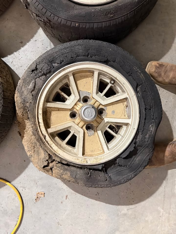

My car is a 1974 MGB that's pretty much stock except for the 18GK engine. It's currently equipped with ROSstyle wheels that are probably original. However, they're rather rusty, especially on the inside, and that's causing some slow leak issues. It's time for a new set of tires, so I was looking at taking the steel wheels off the road for awhile until I can get them blasted and painted, but I'm not ready to stop driving the car since I just got it back from having its windshield replaced. So, I thought a set of alloy wheels might work well with it. No one seems to have any minilites for sale, and I can't spend the money to get them new, so I was looking at other options.
Someone has a set of Datsun "Iron Cross" wheels off a 280ZX from the early 80s on the local marketplace. They're 14" wheels with the 4x114.3 bolt pattern that matches up to an MGB's stock bolt pattern. The seller said they would measure width and offset after work today, but most of what I've found so far indicates they're 6" wide with a +10mm offset and 102mm backspace, and center bore between 71-73mm.
I've tried to attach a picture. They need to be cleaned and have the old tires removed.
Has anyone used a wheel like this on their CB MGB? I kind of like the sort of retro, shabby chic, old school look they give, like something you might see on an MGB that came out of California.

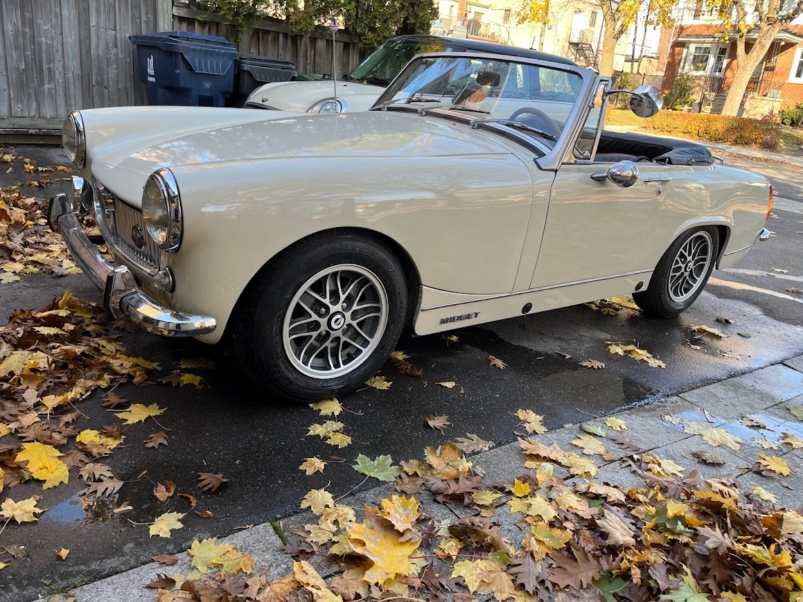

Not necessarily a deal breaker but 280Z studs are M12 while MGB are 1/2" - So the nuts won't work and the Rostyle nuts might not work either. When I put the cosmics on the Midget I was able to source new nuts as the company is still in business. Not sure how that would work for you.

I just heard from the seller. The wheels are 14x6, +10mm offset, and an 80mm center bore hole. To my mind, the concern is the offset more than anything else, but I have seen a pic of an MGB with these wheels installed:
That does look lovely - depending on the price, there is nothing wrong with trying and if it doesn't work pass them on. The market for these wheels is typically pretty strong. Not much to lose and everything to gain.

I've arranged with the seller to get them tomorrow morning. The plan is to mount one of them on the car just to make sure it'll fit. Even though the tires on them are bad, it might give an accurate indication of whether or not the wheels will fit properly. The car in the link I posted earlier is using 185 70R 14 tires, so going this route will likely necessitate using tires in that size, unless 175s would fit better. Hopefully this sounds like a good plan.
