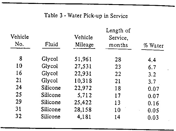

Randall that's a interesting artical from Moss. I wonder if my mistake in rebuilding the clutck and brake system is that I used Lucas PFG102 Rubber Grease? It states that it can be used when in contact with brake fluid. I used the same stuff on my current TR3 rebuild. When they wrote the specs for the grease it may have only been ment to be used with DOT3 fluid. Could this be my problem?
