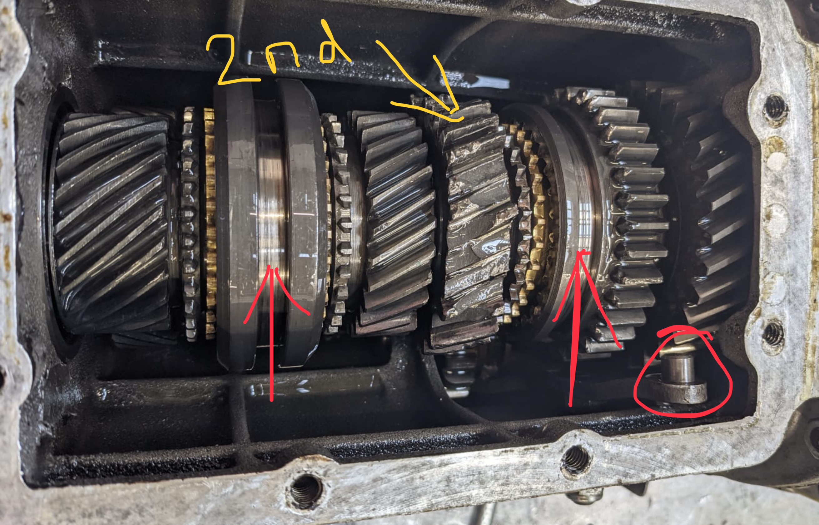

You should (from memory) take off the top of the gearbox to a move the gear lever to check the selector forks move. Just see where they sit in neutral for reassembly
In my picture ignore the yellow arrow- this was a 2nd gear I thoroughly stripped whilst doing a hill climb or sprint in competition
The red arrows are where the forks fit to slide the gears to change gear try levering here.
The red circle is where reverse selects and should correspond to a fork in the lid when you come to refit the lid.
This is an early full synchro tr6 box on my 1959 3a
Thx for the info and the photo. I think I know what may have caused the problem. When I removed the speedometer gear mistakenly loosened the bolt above it thinking that it locked the speedo cable somehow as that was difficult to remove. Anyway I came to find out that that bolt affected the Reverse gear. I made a mental note to tighten that bolt down again. I Forgot to do that unfortunately and I think that was the cause of the whole problem? Now that I see in the photo you sent how things are supposed to line up I will attempt to set things up like that and tighten that reverse gear bolt down.
If it is the bolt I am thinking about...it has nothing to do with the speedo. It is a very long bolt that locks the reverse stub gear into the case...yes, that would cause a jam if the shifter were in 4th with the reverse gear also engaged...
But...as I think about it...I am not sure this is good news. I do not know of a way to align the reverse gear with the bolt without opening the top cover, to reach in and hold the gear while installing the lock-bolt?!?

Do not close the top until you reach in and align the little reverse stub gear and shaft it goes on. If I remember correctly, there is a hole in the gear shaft. The bolt reaches into the case and into the shaft hole, to keep it in position. Also, if the shaft got too far out of position, the little reverse stub gear can fall out into the bottom of the case. So make sure the little gear and shaft are in the correct position, then align the holes in the case and shaft...then re-install the long bolt.

Once your gear, shaft, and bolt are properly installed...and the shifter lever feels normal...then you must place all gears into neutral position and the shifter assembly in neutral. Then the top cover can be gently lowered into position, ensuring the shift fingers go into the gear slots. The reverse fork can be tricky.
