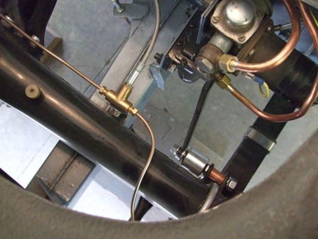

Rob, as has been said here and I will confirm it, the axle housing does rest hard on the rubbers on the top of the frame rail when installed and the car is not loaded and the frame is resting on jackstands. I've attached the best pic I have from when I assembled my car. It is not the best pic for the subject but I think it does show the axle resting on the frame. I think your frame has a bit of a twist in the back. Dave.

Yes, but is his car sitting on jack stands? I think it is sitting on the wheels, and the axle is still hard against the frame. That's not how my car is...
