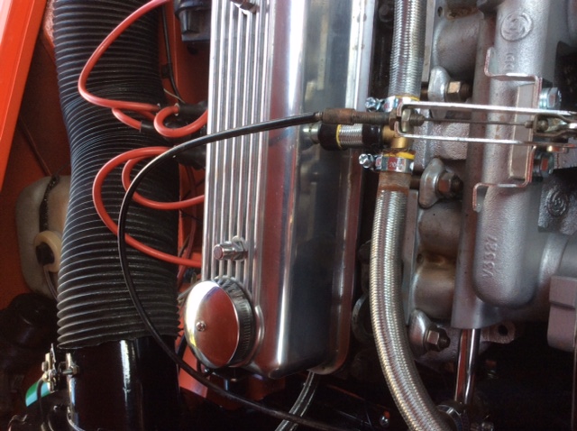

And just on the side I have a screw inserted into the chrome cap of my rocker cover, is this correct ??
JPSmit
George, I am not sure that this picture can really help. The rocker cover is lovely and I see the vent for the engine but, can you post a pic of the carbs themselves?

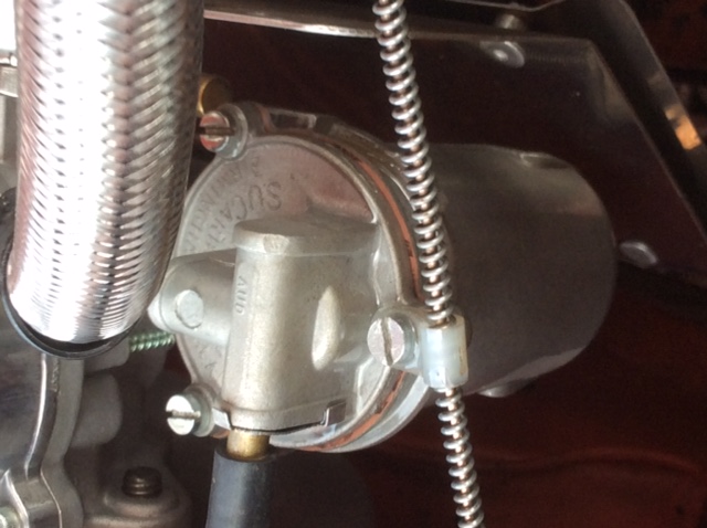

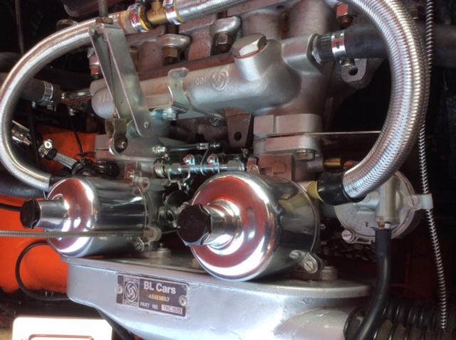

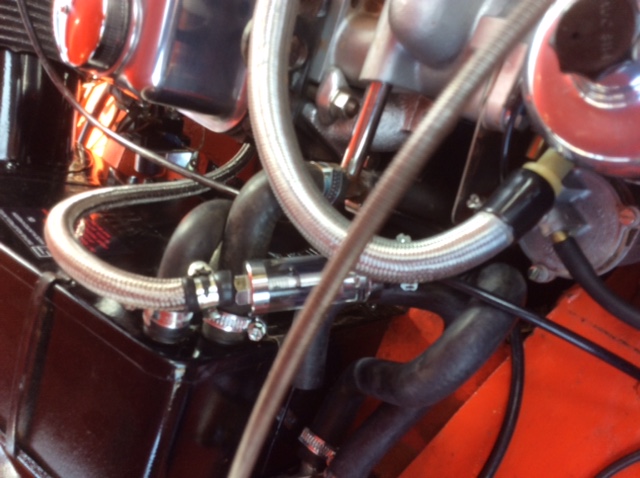

Thanks JP, hopefully you can see fuel leaking from the front float bowl top. Also I'm showing the carbs and the new filter.

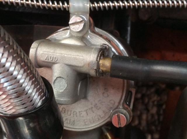

This may show the fuel leak better.

Does the float actually float?
Also, I just noticed you have no clamps on your fuel lines. That could be what's leaking. In my opinion you need some clamps, no matter how tight the lines feel when you push them on the tube. 😁

Thanks Rick, yep no clamps, that line was put on as a temp measure. The real line has clamps indeed.

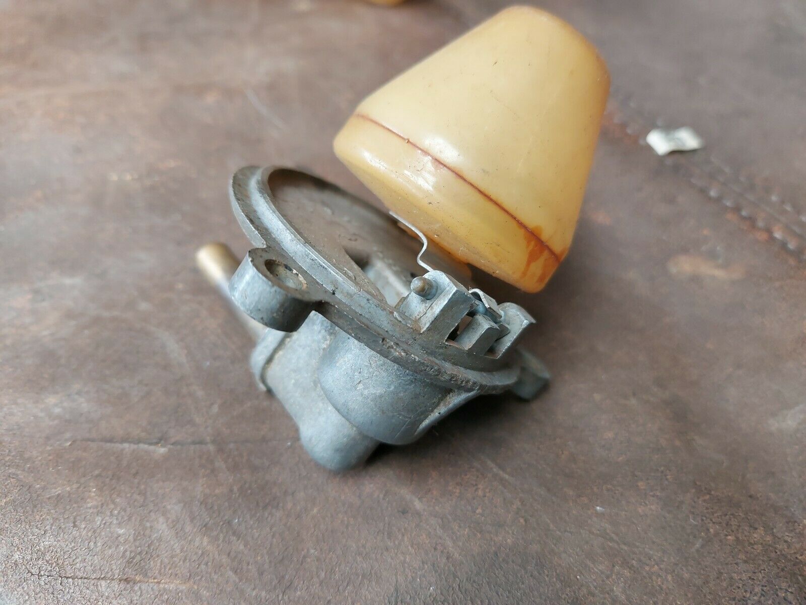

Thanks Rick, I watched the video. My float bowl top is No2277 and does not have the bendy adjuster, I have just ordered an earlier 2276 with the spring arm (Picture) in the hope that it might cure my problem. Not sure how to check the fuel pressure

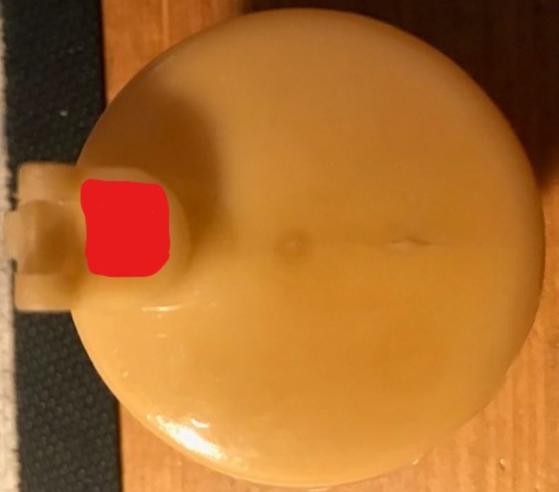

Harbor Freight sells a fuel/vacuum tester (around $14.00) which can be tee'd into the fuel line before the carbs. My only other thought is possibly using a Viton float (Joe Curto and Moss sell these) as I have found the ethanol blended gasoline will deteriorate the original type float.
Meanwhile I glued in place a wee packer here on my spare float here to see if that would help!

is it actually leaking out the overflow vent[which is behind the small metal plate where your fuel line goes on] or is it leaking out of the gasket area? as that gasket looks a bit dodgy to me, sorta home made

I ran into this several weeks ago. I installed new Ethanol Resistant Floats and upgraded to the "Superior" Gross Jets with the Ball Valve. Adjusted Float Height correctly. Started Engine Gas leak from Front Carb. Changed back to old Vitron Tipped valves on front carb, leak stopped and moved now to rear carb, crap, Changed back to Vitron Tipped Valve on rear, reinstalled old valves and leak went away. Problem solved.Order new Vitron Tipped Float Valve and issue will be solved.
