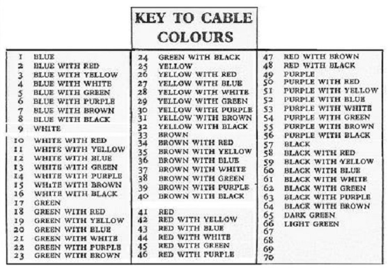

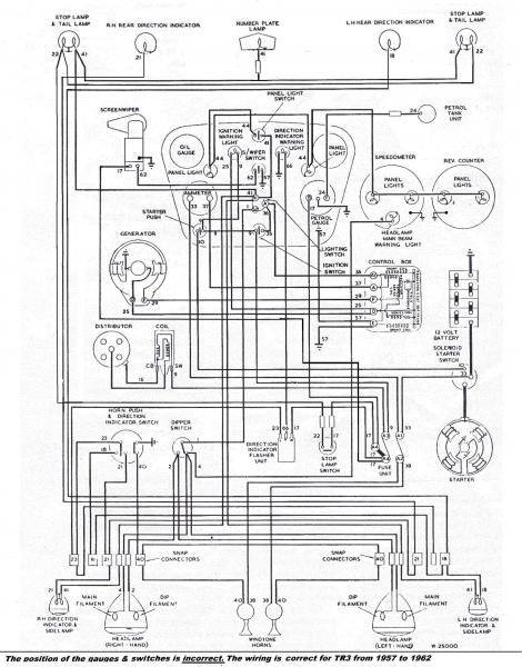

Colors out of left front turn signal should be solid red (parking light) and
green w/red (left turn)
Colors out of right front turn signal should be solid red and green w/white (right turn)
You can find corresponding wires from the harness at the multiple connectors located
next to the horns on each side.
Attached is a wiring diagram that might help.
Frank
