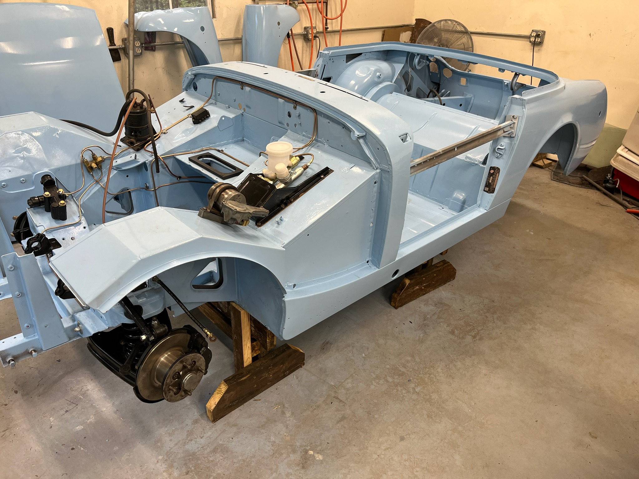

Making progress on the reassembly.

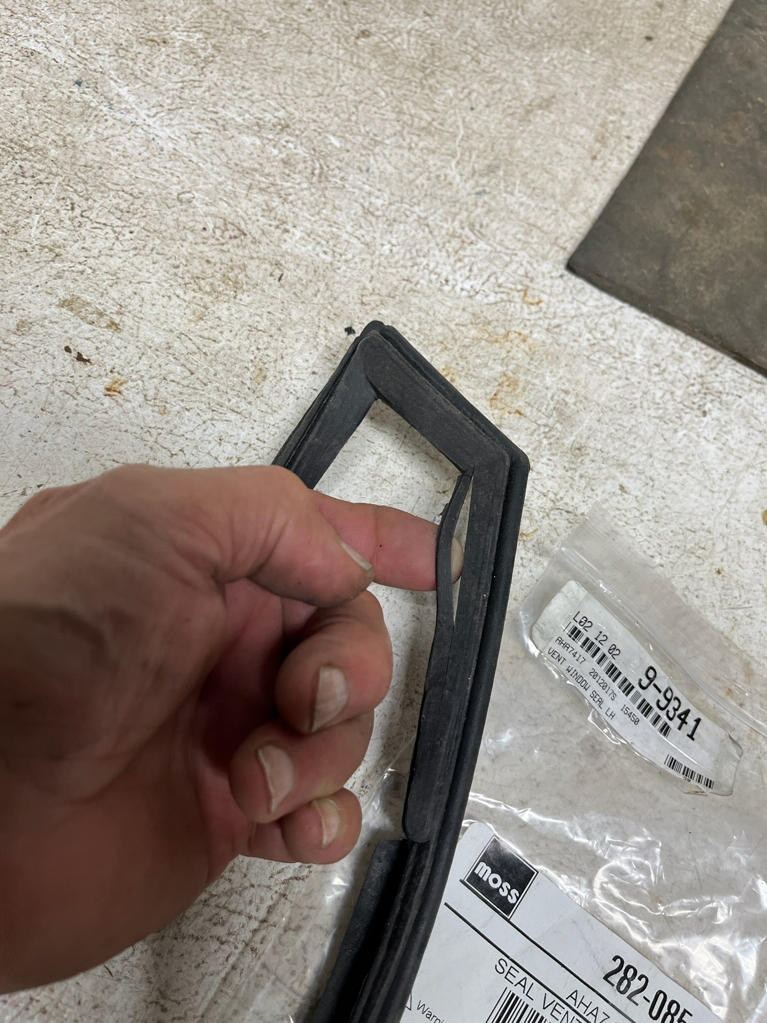

Needing to order rubber parts for my doors I started with Moss UK but found they were out of stock of one side quarter light rubber and do not have prices in US $ any more. British Parts NW parts list seems to be a mess as is MiniMania and Rimmer does not list anything for quarter lights . So it looks like it is back to Moss US The last rubbers I got there were TRASH. Had cuts in them where they had attempted to clean up the molding.

The rubbers I got from Moss US a year or so ago were such a bad fit it took me many hours of trying to trim them so the windows would close. I don't know if Macgregor has them but if he does I think they would good quality.
I did get some rubber parts from Macgregor but he does not do the quarter light rubber seals. I started to think that I may stick with the ones in the car but found that they were crumbling. One side looks like it may work.

A photo of the quarter light rubber from moss.

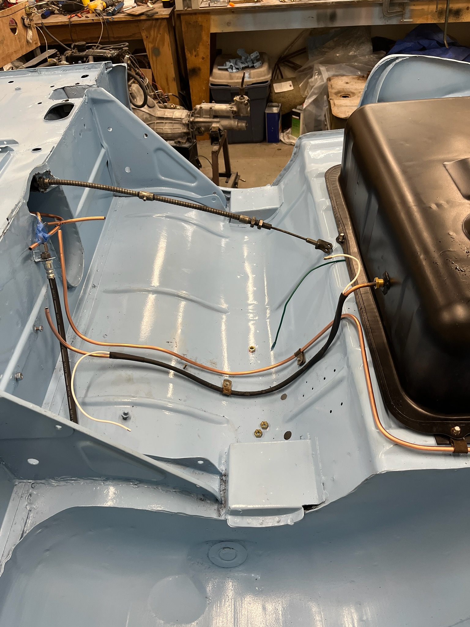

I am finding it easier to run the fuel and vent lines with the car inverted.
lines look great - rubber not so much. Probably the best parts catalogue is probably the Moss website. I have ordered from MGOC over the years - always good service.
