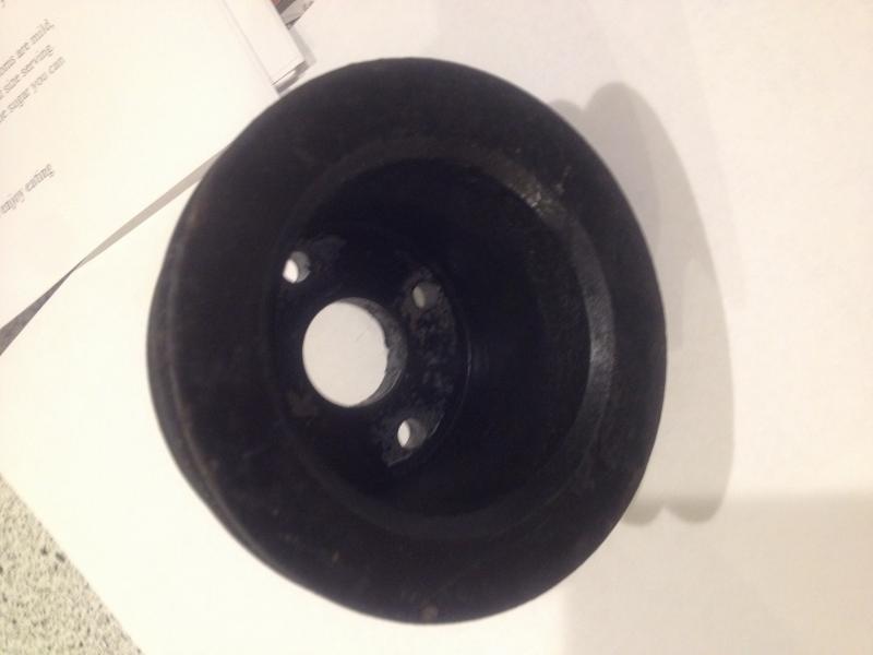

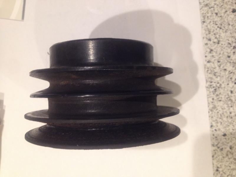

The pulley is not a press fit and should slip on and off easily unless there is too much paint on it or it's rusty. Maybe your pulley is not original or correct. Please post a picture.
I don't remember having this problem when I replaced the pump 30 years ago, when I was out of town. I definitely remember that. I am fairly sure the pulley is original, I bought the car with less than 50k miles on it. There is no rust, 2 pics are attached.

Looks like you need to clean the center, looks a little rough. Sand it down until clean, lightly oil and try again.
Thanks for the tip Larry. Cleaning the center hole on the pulley allowed it to go on just enough so i could get bolts started. I replaced the bypass hose, but it leaked while refilling the radiator. I had left it just tiny bit short on the top, which was hard to see. It was difficult to re-adjust, with the fan and radiator on. Leak seemed to stop with the clamp at the very end of the hose. I will reattach alternator after lunch and go for a test spin.
