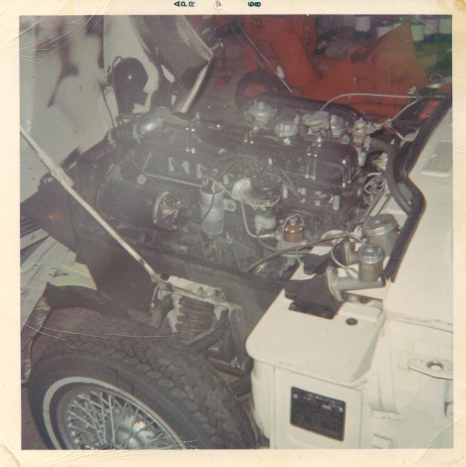

This is the '67 GT6 I purchased new in early 1968. I rebuilt the transmission 2x over the years I owned it. The local tech college rebuilt the diff. once. Even though I drove it very hard it stood up well; much better than the '65 Pontiac GTO I had.
