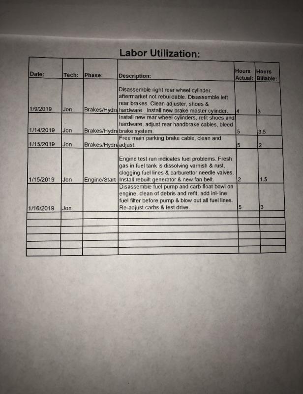

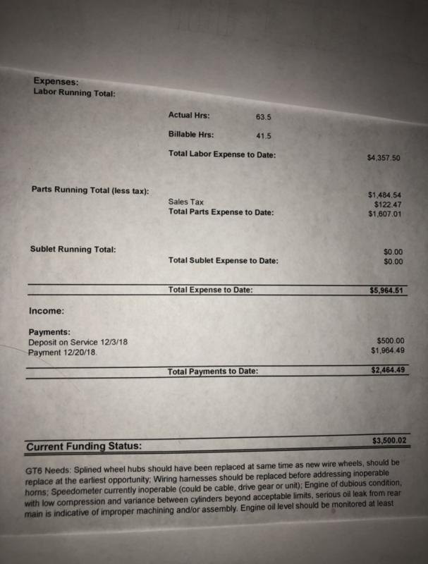

I recently had some work done on the GT6, and I'm not sure that what I paid was actually fair. I haven't had much time to spend on it, so I took the car to a British car specialist near me, a pretty famous one, but they nearly doubled the budget I gave them without approval, and I'm pretty sure the volume of work I got wasn't commiserate.
When I picked it up, I paid the extra $2500 over the budget I gave them of $3500, (which they blew past without ever asking for approval), thinking at least the work would be done correctly and I wouldn't have had to mess with it, but I ended up having to redo a lot of the work they did myself. They replaced both rear wheel cylinders, but after leaving a trail of brake fluid through my garage, I discovered that one of the new ones was leaking quite a bit. When I contacted them about it, they said to "top it off and bring it back in" (20 miles through Dallas in a car with questionable brakes to replace a $15 wheel cylinder?).
That made me actually start to look at the work that was done. According to the invoice, the time to replace 2 wheel cylinders, flush the brake lines and flush the clutch lines was 13 hours. That seems ridiculously high to me for a car where the clutch slave cylinder and both front wheels are accessible just by opening the hood. Does that seem like a reasonable amount to anyone else?
Maybe I'm being unrealistic. I'd like to hear other people's opinions.

That's even less time than I expected. I had figured it would actually take 4 hours, and billing 6 hours to cover road testing and all of the miscellaneous stuff would be reasonable. Not 13.

Well, joke was on me, I guess. I told them to let me know before exceeding $3500. So they invoiced me once in December for $2500 ish, and then when I picked it up in January invoiced me for another $3500.01.

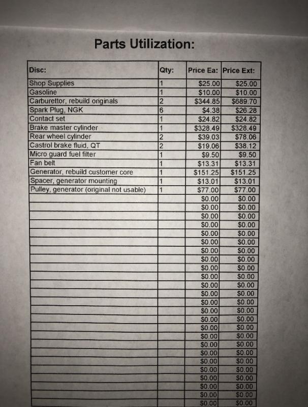

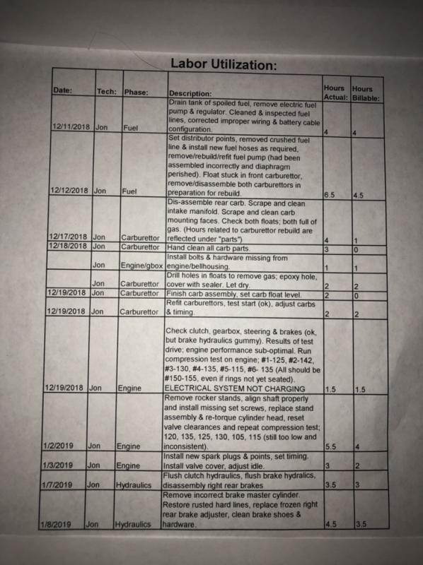

I’ve attached the receipt, and invoices of parts and labor, which may help everyone figure out where the money went, and if we did in fact get scammed.

Based on the attachments above, and thinking strictly in terms of the bottom of page 2/top of page 3 where the labor hours add up to 13, there was more done for those 13 hours than merely replace two wheel cylinders and flush the hydraulics. Granted some of the other work listed would have to be performed in order to replace those two wheel cylinders but replacing a master cylinder and fiddling with hydraulic hard lines would be outside the scope of replacing the two rear wheel cylinders. Does it justify 13 hours? That's hard to say without a better understanding of the extent of work performed for those hard lines and how the work flowed from day to day since the tasks listed covered multiple days.
But getting back to the root of the issue in my mind is the fact that a specific figure was stated as being authorized, yet the final bill was right at 70% higher than the previously stated authorized amount. Again, if this was at a shop within the city of Dallas, unless that ordinance has gone away, this would not be legal under that ordinance without a supplemental estimate being provided by the shop in question and approval for such work granted.

Yeah, not so much. The wheel cylinder that they replaced was leaking fluid all over the garage, and the car wouldn't idle and made a terrific screaming noise when revved. Over the phone he suggested it sounded like the clutch hydraulics were sticking and not letting it fully disengage.
... so that was two of the things that I paid him way too much to do that I had to redo myself. Things that I'd think would have been caught.
Also, the brand new knockoff nuts now have several dings from not using the knock-off wrench that I had sitting on top of the gas tank in the hatch, which they supposedly drained and cleaned. The fuel sender was totally gunked up, which again, I'd think would have been caught when they cleaned the tank, and the rubber seal that goes under the sender with the lock ring, was on TOP of the sender, under a puddle of gas because it wasn't sealing properly.
In fairness, that could have been something I did years ago not knowing any better, but if so that means they charged me to clean the fuel tank without even looking at it, which isn't a lot better.
They also converted it back to a generator because they assured me the alternator setup I'd converted to wouldn't work (despite the fact that it worked fine for years).
After converting back to the generator, the flashers would speed up and slow down with the revs, so I asked if it was potentially a bad voltage regulator, and he said "No, it's due to the aftermarket flasher you've got installed." I said "What do you mean?" He said "The little black cube you've got next to the brake master under the hood".
That's a replacement horn relay that I received from Victoria British - it's true it wasn't factory, but it should be obvious that it's the horn relay given that it's literally right under the disconnected factory horn relay. Especially to a specialist. The flasher is underneath the passenger side of the dashboard, and it says Lucas on it, because it's a factory one.
When replacing the rear wheel cylinders, they pointed at the splines on the hub adapters and said they should be replaced because they're starting to wear thin towards the ends. After ordering replacements to put them on, it turns out the ones needing replacement were nearly brand new, with maybe 500 miles on them. You could also tell because a lot of the axle grease I used to install them was still red.
That's just what I've caught so far.

Yeah, this is what I get for trying to take the easy way out. The problem is I'm in the middle of several other car projects, and this was my wife's car that I kept not ever getting around to. That's why, for Christmas I thought "Okay, I'm just going to take it to someone and get it done right, and spend $3500 to make sure everything I've done over the years is correct, and then she'll have her car and I'll not have it hanging over my head anymore." My actual intent was that more time be spent on the things that specialists do well that take so much skill, like lining up the doors and hood shut lines and hinges and making all of those little things better. Even at their $105 an hour labor rate, I figured 35 hours or so should be enough time to clean the fuel tank and get it running again, do a basic safety check of the brakes and clutch and take care of several of those little things.
My hope was that they'd come back and say "We did all this stuff, etc, and if you want to spend another $300, we can do X, and for $250 we can replace the crappy VB furflex seals with something that actually looks good and doesn't fall off the car when the wind blows, and get the right window seals, etc."
Not "Well, we know you said $3500, but for $5500, we drained the fuel tank, rebuilt the carburetors, rebuilt the fuel pump, replaced two wheel cylinders and bled the brakes and clutch."
For reference, Just Brakes charges about $100 to flush and fill - which is a long way off from $1300
