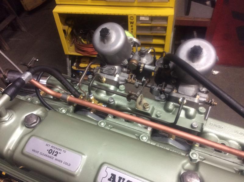

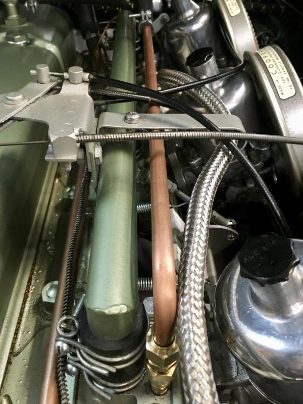

Best install I've seen yet. Did you fab the balance pipe w/PCV line, or did it come with the DMD?
Thank you! Using a Harbor Freight tube bender, I bent it up from 3/8" fuel/brake line steel tubing and did a mediocre job silver-brazing the joint, filling it in with steel epoxy and filing that to look nice. The bracket was sliced off a piece of lightweight aluminum angle. The PCV was scientifically picked by going to the auto parts store and looking for one from a medium-horsepower car that would fit 5/8" in & 3/8" out.
The DMD came with the brass barb fittings and the balance pipe was 3/8" rubber fuel tubing.
