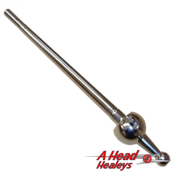

Also, all the pictures of the gearshift lever I see online show a chromed ball at the very bottom that fits into the socket in the picture above, e.g.:

checked mine it had no rubber or plastic bushing on the bottom ball , I would give a call to healey surgeons or join the healey mailing list tons of archives ,ill look it up and see if there is anything about it
