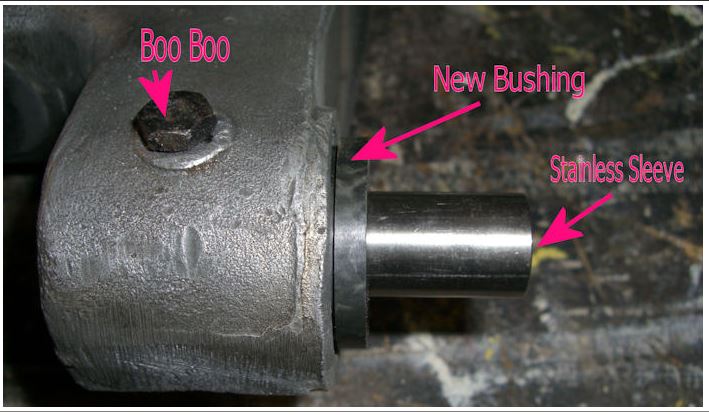

Here is a picture of the inner sleeve from Bob Danielson's excellent Nylatron installation article. I installed these ~2010.
Tim
